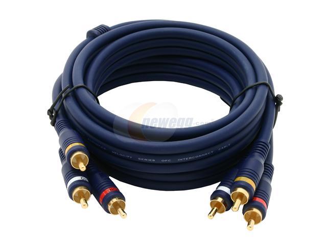

Run composite video (RCA connector, usually yellow) from the VCR output to the PVR-150:
I don't remember if the PVR-150 has a RCA or stereo pin-plug for audio. You'll need either this:
Or a regular RCA audio cable with the red and white connectors at both end. If the PVR-150 has the red and white RCA connectors you can use a single cable that has both video and audio:
PVR 150 has stereo pin plug for audio. And where would I find both cables in more than 6 ft? My setup is about 8 foot from the computer.
You can get 10 to 15 foot cables from most places that sell them.
http://www.newegg.com/Product/Product.aspx?Item=N82E16812196037
http://www.newegg.com/Product/Product.aspx?Item=N82E16882021058
You can get cables like this at any local electronics store of Radio Shack. Don't let them sell on you $100 Monster cables. For VHS at 10 to 15 feet you don't need expensive cables. -

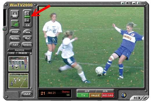

Is there a little green button between the channel up and down buttons? That cycles through the different inputs. Tuner, composite, s-video...Originally Posted by magicfingers

Having explained that, this means, that the TV is connected to the VCR via coaxil. What I explained above, is how the card should be reading from the VCR, but isn't. And my WinTV is the newest model, not like the one you have and there are no green buttons anywhere.
