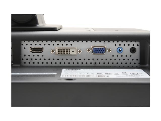

	My monitor has a DV-D Dual Link port
 see
 http://c1.neweggimages.com/NeweggImage/productimage/24-001-263-14.jpg
