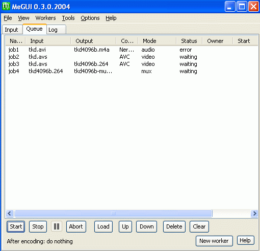

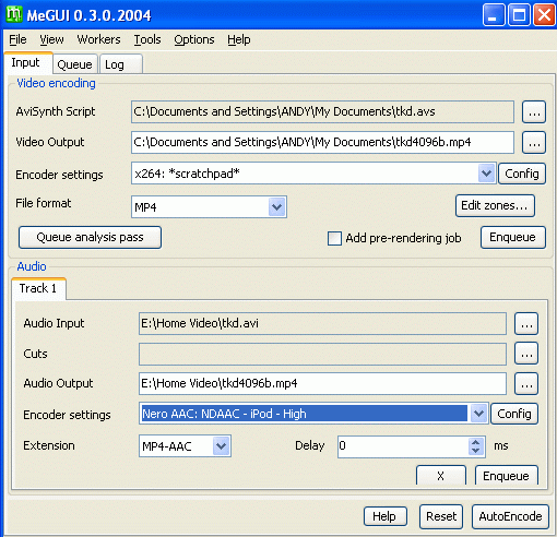

1) check to make sure your audio program paths are set in MeGUI
2) use an .avs script to encode the audio (although you can for some files, I couldn't do it directly with your sample either)
DirectShowSource("PATH\tkd.avi",video=false)
You could have used the same script for both audio & video too:
DirectShowSource("PATH\tkd.avi",fps=29.97,audio=tr ue) -

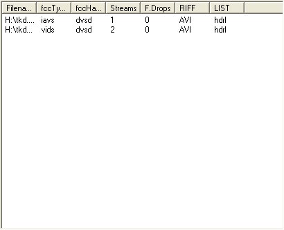

* tdk.avi - in this pic, notice line 1 is only 1 stream. that means its seeing only video
* tdk_new.avi - in the 2nd line, you will see 2, for 2 streams. this means there is video/audio stream
Virtualdub will save to a *new* DV Type 2 format. You don't have to tell it the type, it will know what to do.
Your new dv source will now have two streams, and the rest of your video endeavor should go smoothly from there on. Older versions of virtualdub could not completely open Type 1 files. They would open as video only. But new-er verisons should. You just have to set to "direct stream copy" when you want to resave to a original container. In this case, by coencidense maybe, vdub is default to dv type 2.

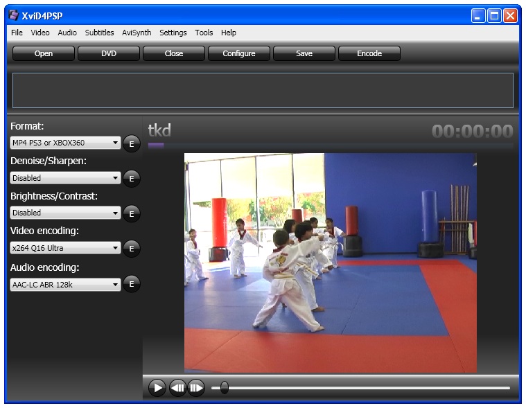

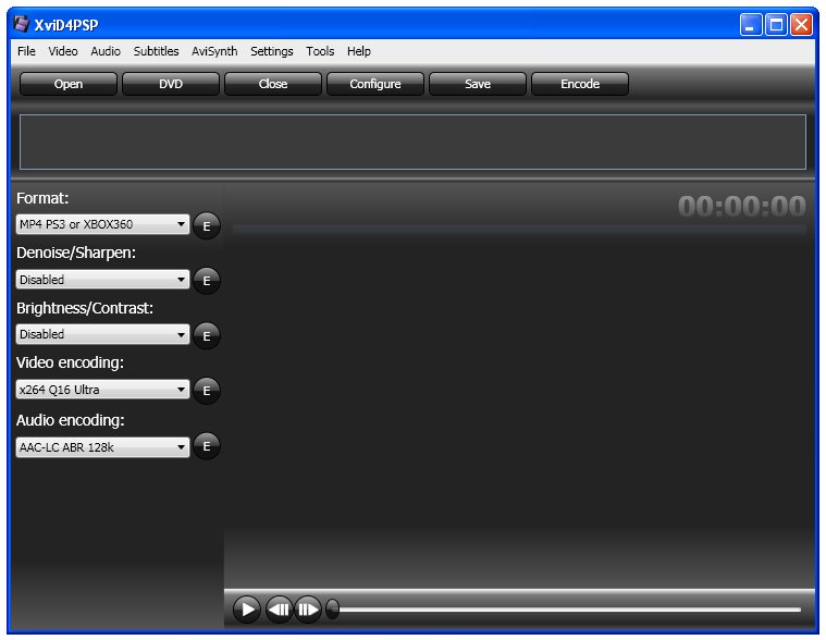

How to do it using XVID4PSP
Load up XVID4PSP
Change the FORMAT option to: MP4 PS3 or XBOX 360
Change the VIDEO ENCODING option to: x264 Q16 Ultra
The screen should look like this:
Now click on OPEN and select the DV AVI file. You will get a screen that pops up that looks like this:
Just click OK and then the video loads and you are back to the main screen (with the first frame of the video now visible as it has been loaded).

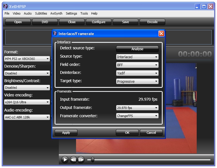

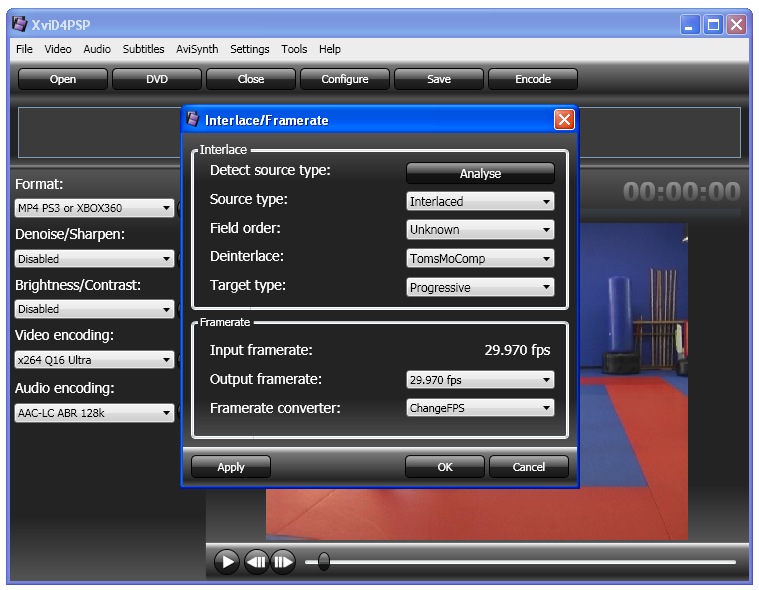

Now go ahead and click on VIDEO at the top (where is says File, Video, Audio, Subtitles, etc.) and under VIDEO select the option called INTERLACE/FRAMERATE and you will see the following:
We all know that the Field Order of DV AVI is BFF or Bottom Field First. So change the FIELD ORDER option to BFF instead of the default of UNKNOWN. At this point you are essentially "done" if you want to use the default deinterlacer "TomsMoComp" but there are other options. I don't pretend to know which is the best thing to use here ... well I would use "MCBob" but that sets the output to 59.940fps (which is how I made my 59.940fps progressive file) but we want deinterlaced 29.970fps so you don't want to use "MCBob". I decided to try "Yadif" and this is what my screen looks like:
When done click on OK.

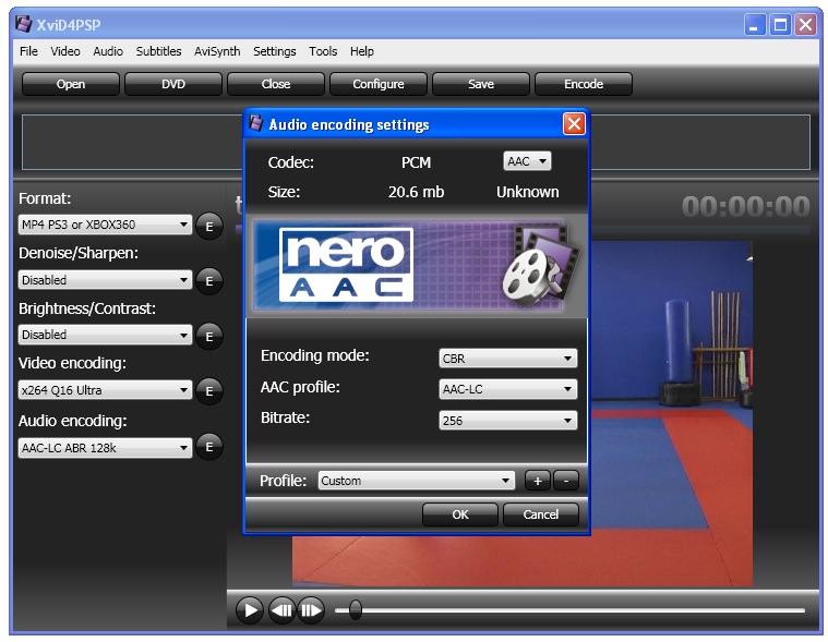

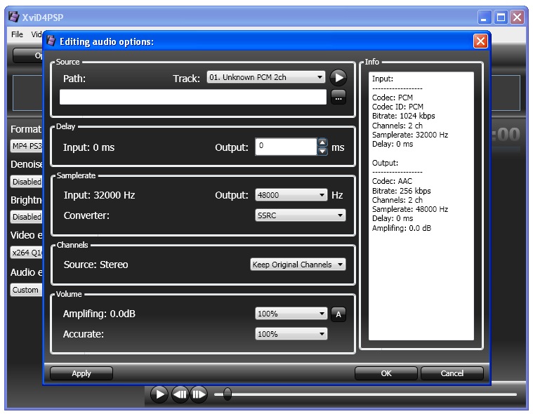

Next up is the audio. The default is a bit low quality if you ask me. On the main screen next to where it says AUDIO ENCODING there is a LETTER "E" icon. Click on that and a window opens up that allows you to adjust the audio. In my example I am doing 256kbps CBR AAC-LC audio:
In the image above I simply changed the ENCODING MODE from ABR to CBR and then I changed the BITRATE from 128 to 256.

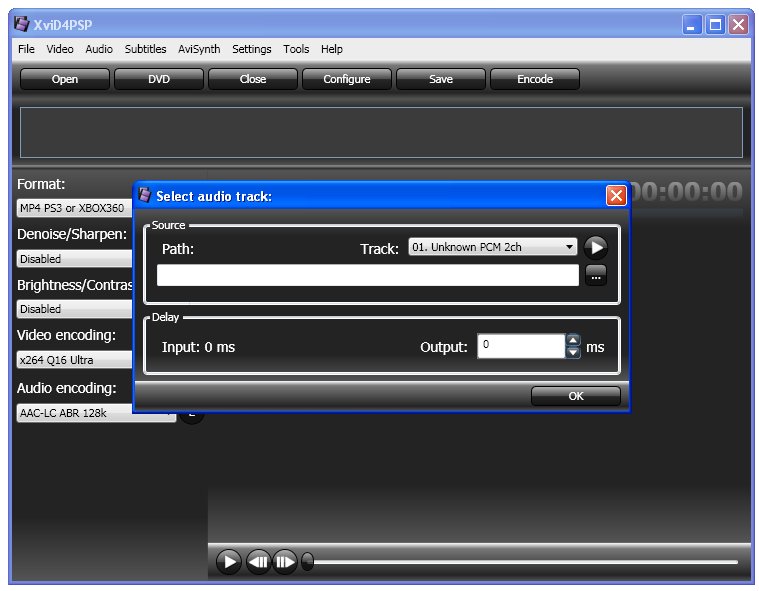

After clicking OK on the above I want to make sure that the audio is "proper" as I call it LOL
At the top click on AUDIO and under that select EDITING OPTIONS and you will see this screen pop up:
Change it so that it now looks like this:
Now click on OK.

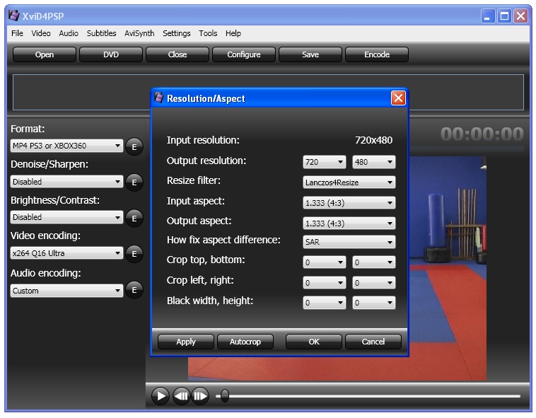

OK you are finished ... almost. For some reason I can't figure XVID4PSP doesn't set the aspect ratio correctly. I had the same problem with the two MP4 files I made earlier. My solution? Run it through YAMB to set the aspect ratio. YAMB will then create a new MP4 with the aspect ratio set correctly. Inside YAMB you will select "4:3 NTSC" for the aspect ratio. The new file will now play correctly. Please note that the new file is simply an exact digital copy of the original except the header info is changed and thus the aspect ratio set proper.
There is another option to the aspect ratio "fix". In XVID4PSP there is an option under VIDEO called "Resolution/Aspect ..." and if you go in there you can change the output to 640x480 instead of 720x480. When you go there you will see the following:
See where it says 720 with a little down arrow next to it? Simply change that setting to 640 and click OK and the file will be 640x480 (instead of 720x480) which is a 1:1 pixel resolution. Thus the aspect ratio will be fine once you output from XVID4PSP and there is no need to worry about it.

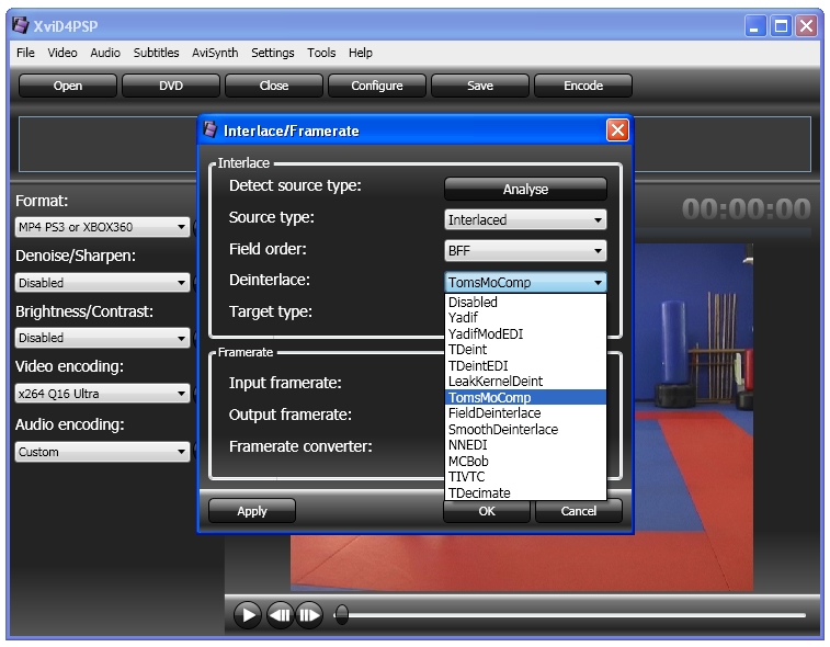

I forgot to mention ... here are the options for deinterlacing that XVID4PSP has built-in
It defaults to "TomsMoComp" but is that best? I sure don't know. In my example above I tried "Yadif" and I'm not sure I am entirely happy with it. I think it can be better.
My hope is that someone can suggest which of these deinterlacing options might be the "best" option.

Depends on how much time you have. The fastest decent ones are, in my opinion, Yadif, TDeint, and LeakKernelBob. Personally, I use Yadif. Here's a deinterlacer comparison jagabo did a while back:My hope is that someone can suggest which of these deinterlacing options might be the "best" option.
https://forum.videohelp.com/topic354397-30.html#1877202
The better ones available within XviD4PSP (like MCBob and the EDI variations) are pretty slow. -
Well I did use Yadif and I wasn't that impressed but then again I do realize that true interlaced 29.970fps will never look really good when deinterlaced and I've always been "sensitive" to "bad" looking video. In other words if Yadif is considered as good as it gets (more or less) then it probably is fine and acceptable and I'm just being "picky" if you will.Originally Posted by manono
