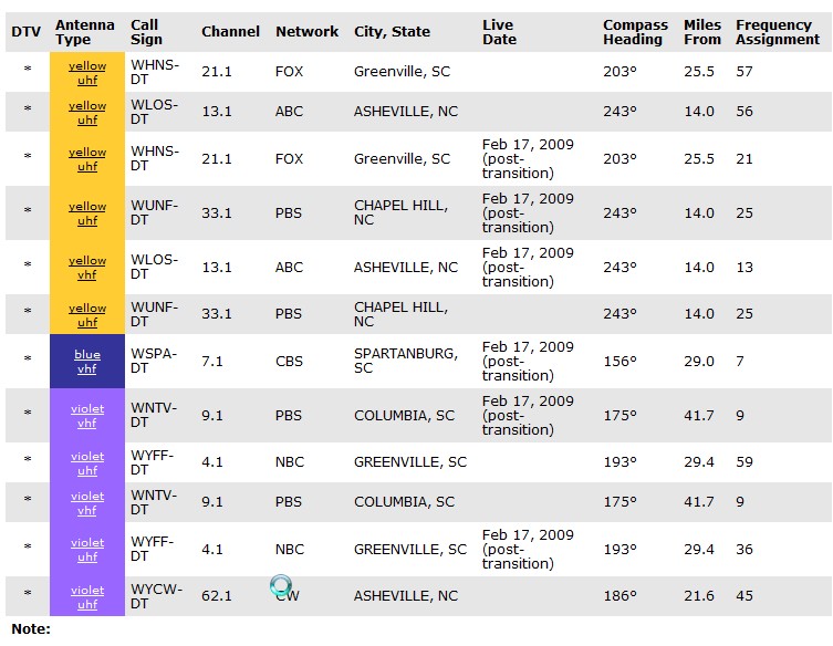

    Put your address into http://www.antennaweb.org/ for a list of likely channels and the types of antennas needed.
    Their database takes into account terrain, direction/distance to transmitter and transmitter power. You may need a different antenna to reach the other channels.
    I just ran a downtown Ashville Zip code and here is the list their. Your stations are in all directions and a mix of UHF and VHF making antenna selection difficult. NBC and Fox are in Greenville, SC 29 miles away. That may take a roof top directional antenna.
    You also see in the list that channel numbers change on Feb 17, 2009. These will be new permanent transmitters and towers that will likely have greater power.
    Channel 36 for NBC will carry better than their current temporary channel 59.

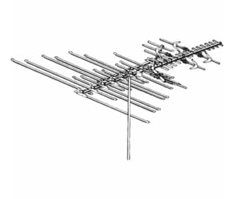

    The yellow code stations should come in with an indoor antenna. The blue and violet codes need a large UHF-VHF (high band VHF for Ch 7,9) directional antenna on the roof pointed ~175 degrees to span 156-193 degrees. An amplifier may be needed.
    Such as the Winegard HD 7084P
    http://www.winegarddirect.com/viewitem.asp?p=SHD7084
    You can use an antenna coupler to connect both antennas.
    http://www.winegarddirect.com/viewitem.asp?p=CC7870

    The Blue and Purple ratings for some of the South Carolina stations may be due to current low power temporary DT transmitters, small temporary antenna towers or terrain blockage (trees or hills).
    Did you run your address? Your predicted reception may be very different from downtown Asheville.

    Using WYFF (NBC Greenville, SC as an example)
    http://www.rabbitears.info/market.php?request=station_search&callsign=WYFF then look at tech data for FCC link.
    http://www.fcc.gov/fcc-bin/tvq?facid=53905
    Analog channel 4. Lower VHF channels propagate further with lower power.
    This station goes off air on Feb 17, 2009.
    Temporary DT UHF channel 59. Power = 392 Kilowatts from a 577 meter tower.
    This station is operating with lower power. Also channel 59 has less range vs. future channel 36.
    Temporary DT UHF channel 36. Power = 1000 Kilowatts from a 522 meter tower position.
    This new transmitter goes on the air Feb 17, 2009 and has 2.55x more power.
    Permanent DT UHF channel 36. Power = 1000 Kilowatts from a 577 meter tower.
    Looks like they are raising the antenna 25 meters to replace the channel 59 antenna.
    So you may need a Purple rated antenna to receive Ch59 but you might get by with less with Ch36. Repeat this research for every station you wish to receive.
