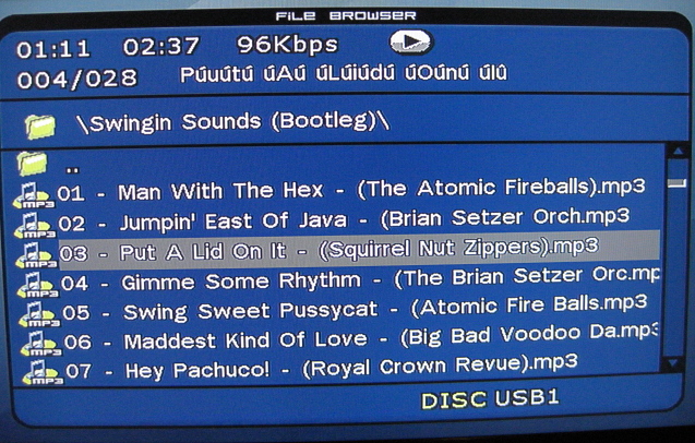

    Nov 2009
    Canada
    I need a little help with MP3 playback.The current MP3 file name listed at the top under the Bitrate contains
    invalid characters, show in the attached image.I am using the 4.1 firmware.
  22. VH Wanderer Ai Haibara's Avatar
    Jan 2006
    Somewhere on VideoHelp...
    Check whether or not those characters exist in any of the MP3's ID3 tag fields.
  23. My guess the file names are unicode, not ascii.
  24. VH Wanderer Ai Haibara's Avatar
    Jan 2006
    Based on what I saw from the picture, it looks like the filenames (in the browser) are okay, but the ID3 tag name (song title) is the one that's probably in Unicode (or at least a double-byte/extended ASCII language encoding).
    (Haven't played many MP3s using my 5990, so I'll have to double-check whether or not the line at the top references the tag fields.)
  25. Originally Posted by Ai Haibara
    That's what I thought at first but when I played an MP3 file there was nothing there at all (I intentionally named a file different than it's tags to be sure I could tell which was being displayed). So I thought maybe it wasn't tags being displayed there. Of course, the name of the file didn't appear there either, so the logic of my assumption was flawed. I'm running a mod firmware so maybe that's the reason there's nothing displayed there.
  26. VH Wanderer Ai Haibara's Avatar
    Jan 2006
    Powel appears to be using the mod firmware, too.
    It appears to have something to do with the ID3 tag versions being used. I had a directory with some random MP3s on one of my USB pen drives, so I tested it. Of the handful that actually had anything in the Title field, the only ones that showed up were either (according to MP3Tag) ID3v1, or ID3v1/ID3v2.3. Two of the ones that showed up as having ID3v1/ID3v2.3 also had their titles appear as in Powel's image, with the umlaut u between (before and after) each letter.
    I guess the answer might be to make sure the tags are in ID3v1 format.
    (Edit: fixed the MP3Tag link to point to the English homepage.)
  27. Member
    Nov 2009
    Canada
    Thanks for the input, I checked my tags which are both ID3v1&ID3v2 all tagged with Tag&rename 3.5.2
    all my mp3 seem to do it.
    Not really a big deal considering the great firmware...
  28. VH Wanderer Ai Haibara's Avatar
    Jan 2006
    I experimented with changing one of the MP3s with the "ü" problem to ID3v1 only (had to use Winamp, though ), and it didn't seem to have the problem. I'm not sure yet whether or not having both format tags present in an MP3 can 'confuse' the 5990, as it doesn't seem to happen with every dual-tag-format file.
    Of course, it's not really THAT big an issue, as you mention.
  29. If you have a Hex Editor (UltraEdit is OK), see if tag is like in this pictures (at end of file).

  30. Member
    Nov 2009
    Canada
    Tags look fine in the Hex Editor
