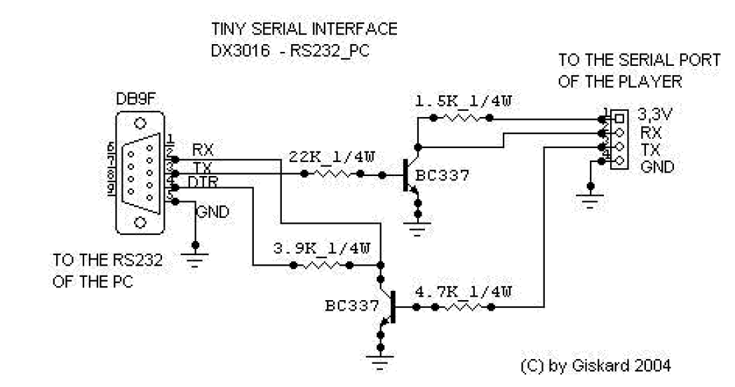

I could not load firmware into a bricked PhilipsYou can either build a serial cable to reflash your dead player or try to return it for an exchange.
Here are the links with detailed instructions and the tools you'll need...
http://vb6rocod.xhost.ro/reflash.html
http://pioneerfaq.info/english/dv400.php?player=DV-400V&question=Dead_Player
http://leoricksimon.blogspot.com/2007/02/upgrading-divx-player-firmware.html
DVP5992/37 using the Serial Interface circuit
(by Giskard) suggested by vb6rocod in:
http://vb6rocod.euracks.com/reflash.html
The circuit failed because the zener diode only
gave about 2 volts at the player RX pin. Note that
the diode's volts vs mAmps curve indicates that its
nominal 3.3v voltage is reached at 76 mA, and that
a voltage below 2v is to be expected at less than
1 mA, which is the current the diode actually gets
through in the suggested circuit.
I did succeed loading the firmware, -but only after
inserting a 2200 ohm resistor in series with the
diode, which caused the operating voltage at the
player RX pin to rise to 3.0 volts.
BTW, Giskard now suggest a more elegant circuit,
eliminating the zener diode and feeding the transistor
from the player 3.3v pin, instead of the PC DTR pin.
