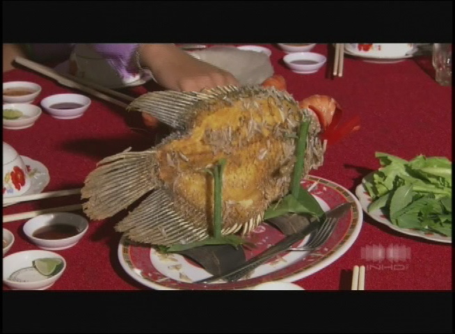

You didn't ID the model of the Motorola box but most have S-Video and "RCA" stereo audio out and the GL-2 accepts both as input.Originally Posted by Canon GL-2 Guy
All the Moto boxes I've experienced letterbox HD to 16:9 SD 720x480i so it looks like ths from HD channels.
