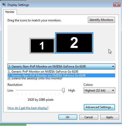

You start with the TV on, PC off, then connect HDMI. Boot PC.
Menus differ by chipset and connection but you start in Vista with "Personalize" (Right click desktop), then "Display Settings" where you set the second monitor and choose a resolution. Something like this...
Then click "Advanced Settings" and follow the NVidia menus.
Here is a sample procedure but for analog component instead of HDMI.
https://forum.videohelp.com/topic344750.html?highlight=geforce%206100Recommends: Kiva.org - Loans that change lives.

Thanks for the explanation that is very helpful. I will give this a try as soon as I get an HDMI to DVI connector or cable.
The menu settings won't appear until you boot with a HDMI->DVI-D cable connected to the HDTV. Make sure that the DVI-D port is selected at the HDTV.
