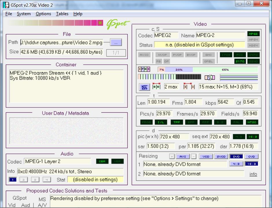

Correct - I believe. It is a recognized 16:9 file when I put in tda2.0 for authoring without any tricks. (I don't know about any "resizing" persay as there isn't any noticeable distortion or loss of quality).Originally Posted by jagaboo
@fulcilives - actually one of my widescreen cap tests was off the ps3 for HEAVENLY SWORD with the results I mentioned
Donatello - The Shredder? Michelangelo - Maybe all that hardware is for making coleslaw? -
Could you post a small cap of the same source captured each way? (4:3, 16:9)?Originally Posted by yoda313
