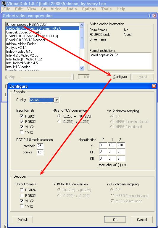

    No. Start VirtualDub. Go to Video -> Compression... Select Cidocida. Press Configure. Set the output format:
    The output from Cedocida will now be YUY2. No need to ConvertToYUY2(interlaced=true) in AviSynth.

  13. VirtualDub has some kind of bug that makes it unable to open DV AVI files directly when the decoder is set to output YUY2. This is weird because it can open any other kind of file that outputs YUY2. (You can get around this problem by also enabling RGB output.) If you are using AviSynth this won't be an issue because AviSynth will be opening the AVI file, not VirtualDub.

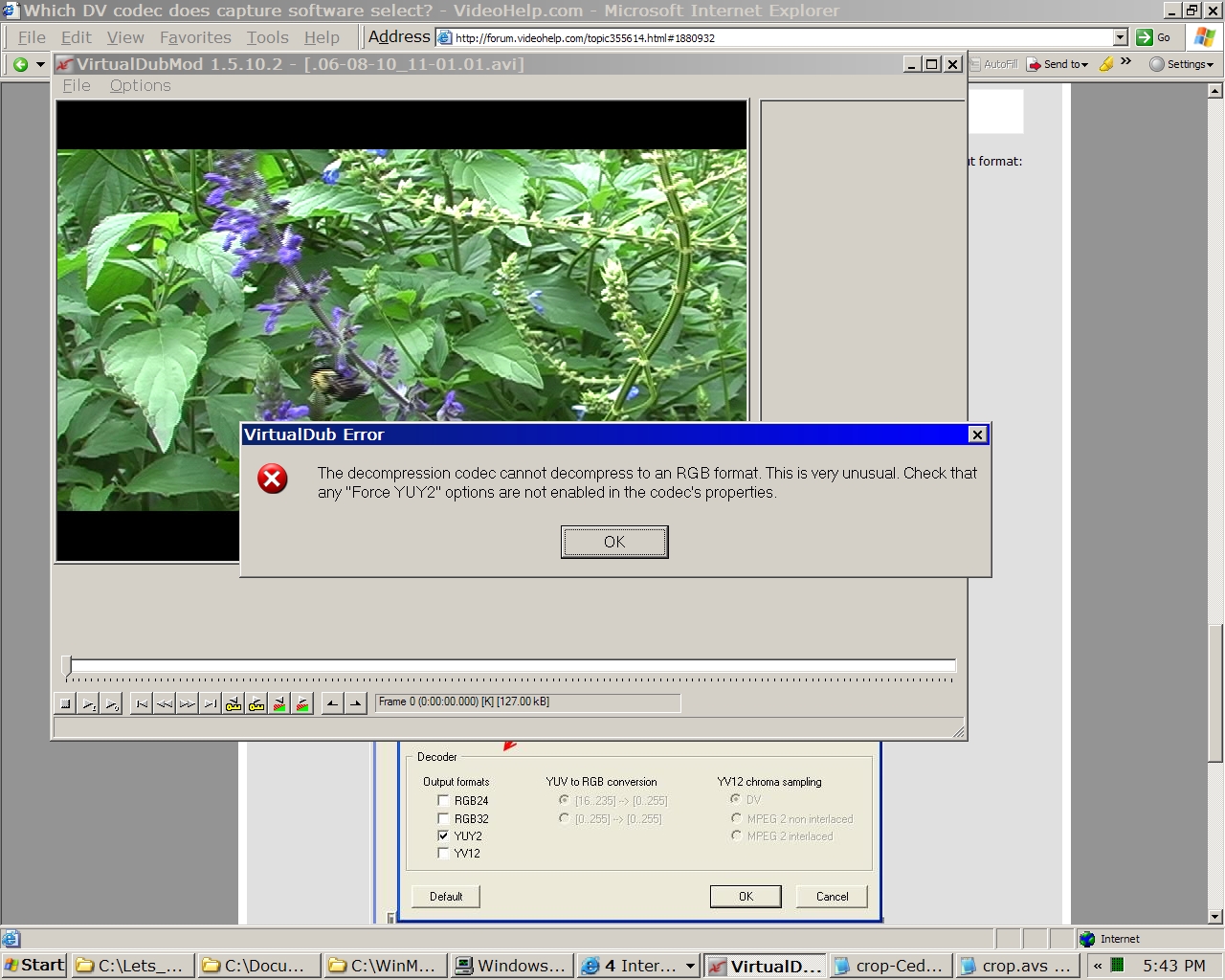

    Tried RGB out (both 24 and 32). But now get VDM "Output compressor error: The source image format is not acceptable (error code -2)".
    The source was "captured" with WinDV. And I opened an AVS file with VDM. The AVS script is:

  15. The AviSynth script looks fine. What compression codec are you using? If you are trying to compress to DV you can't use 640x360. It has to be 720x480.
    By the way, you can use Info() in your AVS script to view the current video properties.
