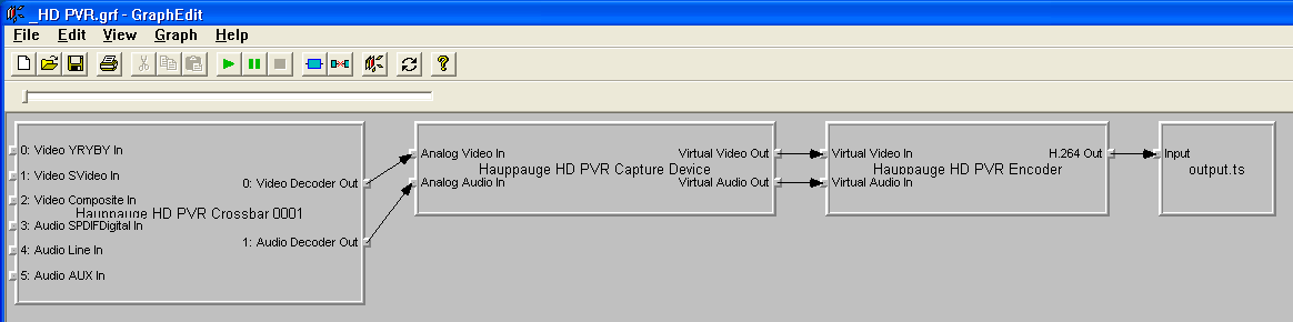

  20. GraphEdit instructions:
    http://www.avsforum.com/avs-vb/showthread.php?p=14454525#post14454525
    After building the graph it should look like this:
  21. I click on DirectShow Filters and it makes graphedit crash. I'm running Vista 64-bit btw.

  25. My graph.
    I managed to get the graph made but when I click on play at the top, I get this.
