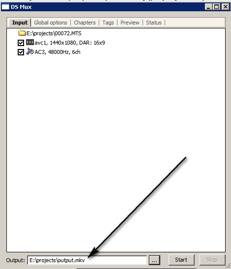

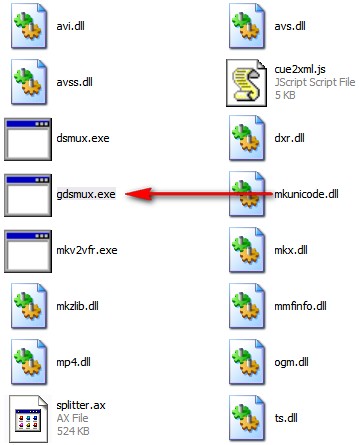

  2. I saw that already and I installed Haali Media Splitter and I can't find the program in the screenshot below. I'm also trying to convert the stuff to 29.970 or 23.976 like the MKV files I have .

    You have 2 or 3 options:
    1) Just straight remux the TS file to MKV with gdsmux. All the file properties are the same as the TS source
    2) Feed the TS file to AutoMKV and configure it to whatever output format you want. Rename the extension from .TS to .M2TS if you get an error from AutoMKV
