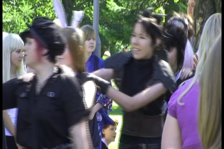

I have a Sony HDR-CX7 camera. I recorded some material on 1440x1080 resolution and used Vegas 8 to render its M2TS files into a DVD quality of MPEG-2 (720x480 29.97FPS).
Sometimes I get a good quality video without any problems (except it's a bit blurry when there's motion, but that's the camera's fault, I guess) and sometimes I get these lines, like interlacing? I don't even know how to call them. I included a sample picture - these lines occur when there's fast movement inside the shot even when the camera is still.
This, however, is not a problem with the camera, the M2TS file is played perfectly fine.
I tried rendering small M2TS files and tried different encodings, but that problem didn't occur in small files for some reason.

	Your picture shows what happens when you resize interlace source directly. There are various techniques. One that I like is AVCHD or HDV 1440x1080i conversion to 1440x1080p @ 59.94 fps (Cineform codec), then resize Cineform to 720x480p @ 59.94, then encode to 720x480i DVD MPeg2.Originally Posted by Animy
 I have a thread on here somewhere detailing the process.
 PS: I see you are in PAL land. Substitute 720x576 in place of 720x480 above. Substitute 50 fps for 59.94.
 You can also edit 1440x1080i, then export HD edit master as uncompressed 1440x1080i for 720x576i conversion with avisynth. Then encode to 720x576i DVD MPeg2Recommends: Kiva.org - Loans that change lives.
