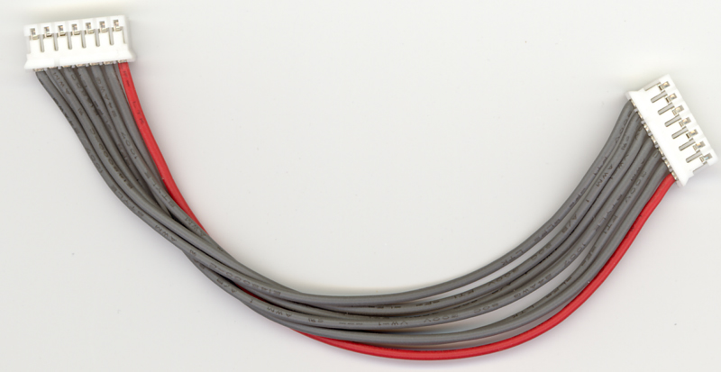

  21. Got my recorder back from JVC. According to the invoice, the problem was the DVD-Drive (no big surprise there). They charged $135.00 for the drive replacement and $90/hr for labor, which they spent one hour on it.
    One thing I am confused about though -- they attached this cable to my invoice, just sorta taped it on there, without any explanation of what it's for or why it's there. Is this one of the parts they replaced maybe? Somebody clue me in
  22. Nevermind. I dug deeper into the giant box of packing peanuts and found the drive they replaced as well, along with the circuit board it connects to on the bottom, and it's clearly the power cable to the drive.
    Any suggestion what I should do with this old drive? Should I just trash it?
  23. Video Restorer lordsmurf's Avatar
    It may simply need a cleaning. Personally, I'd keep it for study. But then again, if I knew it was crap, I'd toss it.
  24. Well I gave it a good cleaning before I sent it off to JVC and I'd assume that they fully checked it out and found it was dead. I'm a packrat though, so I'll probably wind up keeping it for now!
