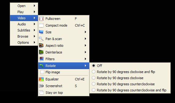

  3. Easiest way is just to use a media player that can rotate the view for you (the clip is not permanently altered, just the display of it). An example is Mplayer, just right click and there is a sub-menu for many functions
    If you want you can re-encode it (you will lose some quality) with a rotating filter. You can do this with avidemux with it's built in filters
