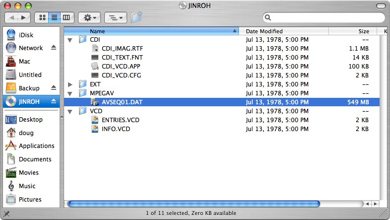

this is the file structure of the VCD (Below):
I'm dragging the DAT file to the source window (which it reads as a mpeg1video, yuv420p, 352x240, 115 kb/s) then selecting the iPhone preset from the video format window.
