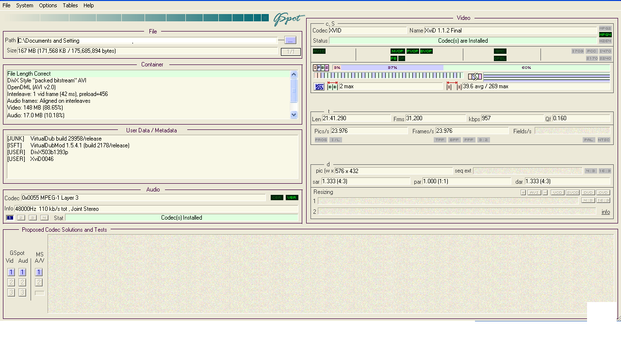

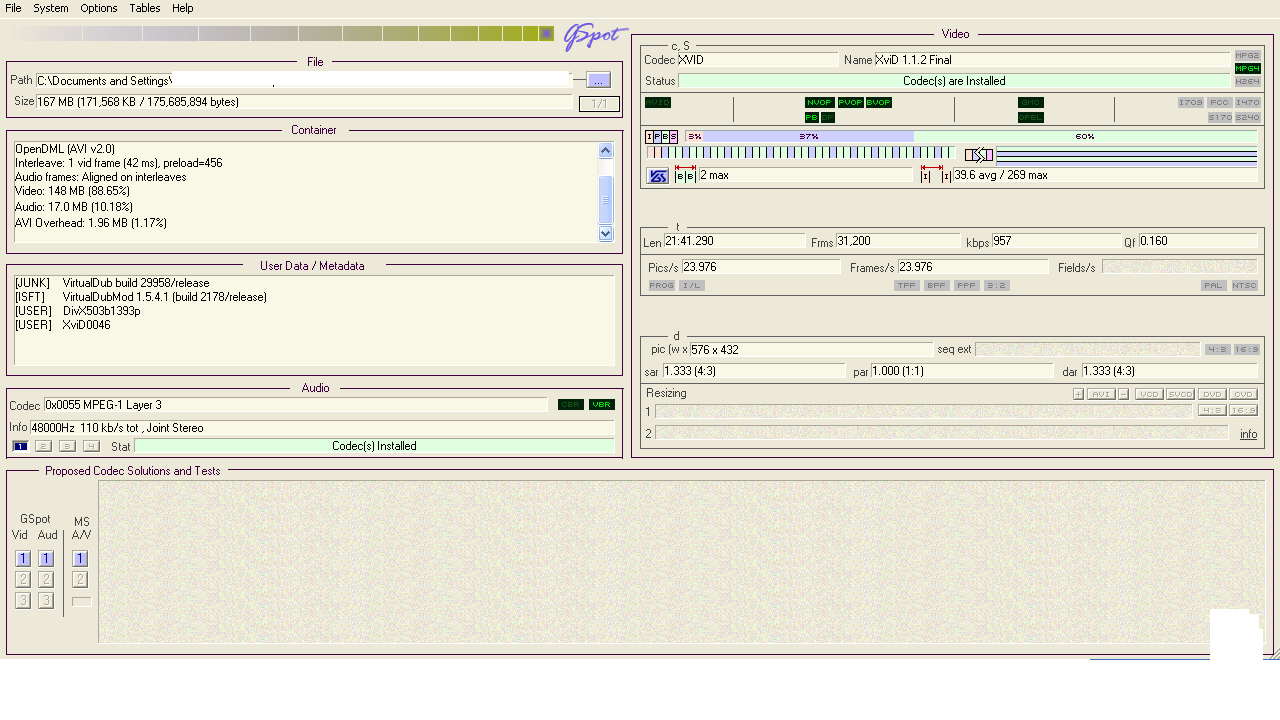

I have been using jagbo's great advie and havent had any problems but when I was en-coding this one set of files (4) I used all of the same settings as advised and everything seemed fine but when I went to play this in the ps3 it said "unsupported data" So here are 2 caps of the file in gspot to see if you can find the problem.Thanks
gspotcap1.bmp -
The PS3 may not like packed bistream with 2 consecutive b-frames. The Divx Home Theater profile uses packed bitstream with only one b-frame.
For these files you can do as guns1inger suggest and unpack them. In the future try encoding with only one b-frame. -

Anyways,I did what you guys suggested and I left all the settings in that program the same,All I did was check the box that said "unpack" and then saved it and it still will not play =\ Any other ideas? -
