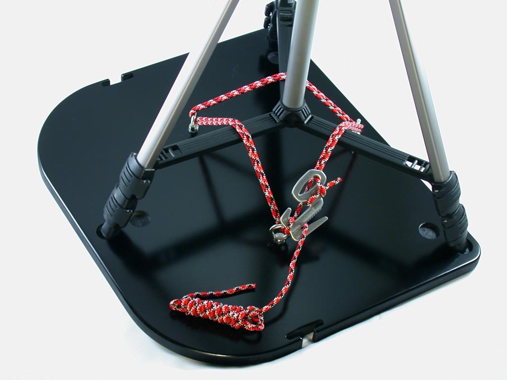

    For anyone still looking for a solution, here is a camcorder mount that you can install in your back seat (or front seat). The seatbelt holds it in place and it uses a tripod to hold your camcorder. It's called Tripshot.
    [urlhttp://www.azimotion.com[/url]
    And here's a picture of it:
    Good luck
