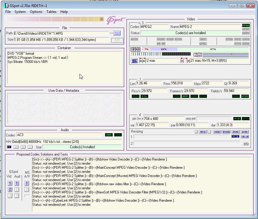

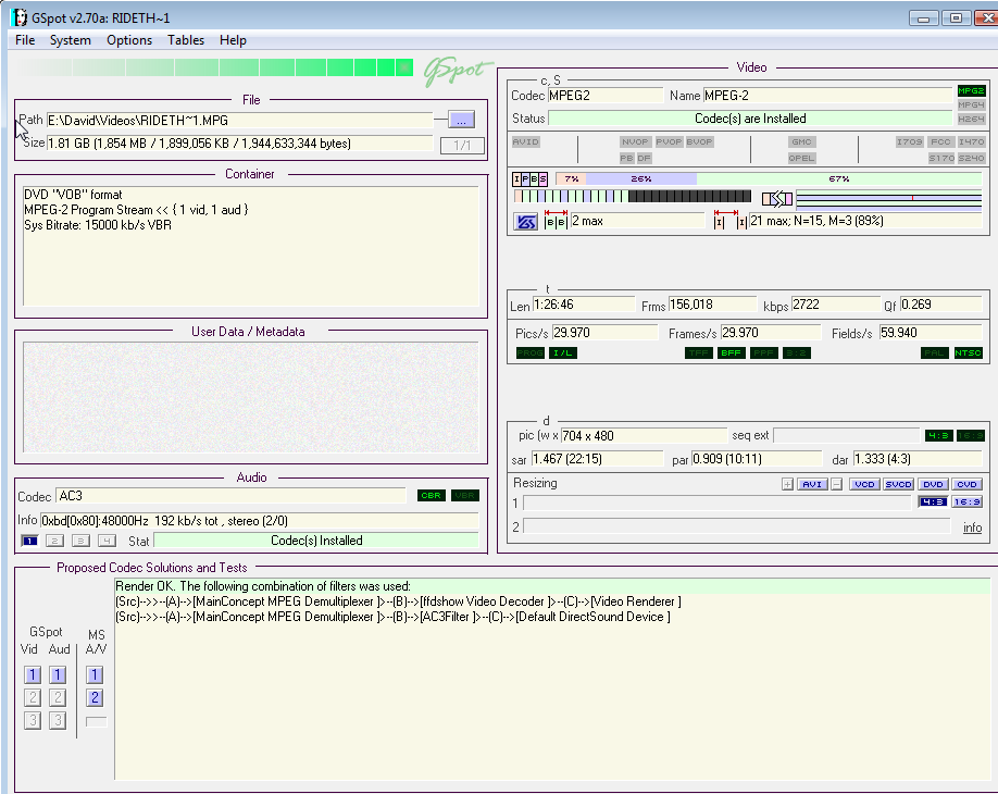

Below is the Gspot output after clicking on button 1 under "MS A/V". I notice that it uses the Mainconcept splitter instead of the PDR. Button 2 under this heading renders and plays the file successfully. Button 2 under "Gspot Vid" gives "Failed to connect output pin" error message for each of the six splitter/codec combinations.
snap0011.bmp -

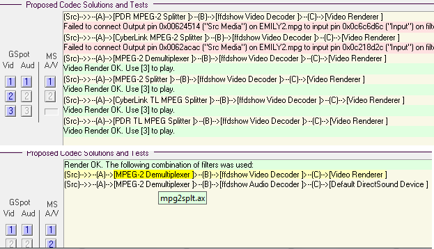

OldAmateur,
I'm running Vista and don't have a problem with thumbnails on mpg files. Comparing my Gspot to yours, the main difference I see is in the splitter. (Mine, like yours, does not like the PDR splitter. I don't have Mainconcept). My computer is using Microsoft's built-in MPEG-2 Splitter, mpg2splt.ax, which isn't showing up on your screenshot for some reason. Maybe your Mainconcept is choking on something, I don't know.
You might try re-registering the MS splitter by typing "regsvr32 mpg2splt.ax" into an administrator command prompt (type cmd into the search box, then hit shift+ctrl+enter; it'll say administrator in the title bar of the window). You may need to raise its merit versus Mainconcept. I'm foggy on that stuff, I haven't had to mess with it in a long time.

Thanks for the suggestions. Unfortunately, none of them has stopped the 'thumbnail' crash. Re-registering the MS splitter had no immediately noticeable effect. Unregistering the PDR splitter makes Gspot try to use the Cyberlink MPEG-2 splitter, which may well be essentailly the same as the PDR module. It did allow Gspot to render successfully using the Mainconcept splitter, but that seems to be irrelevant. I may try uninstalling Cyberlink PowerDirector (source of the PDR modules) anyway, since I never use it.
