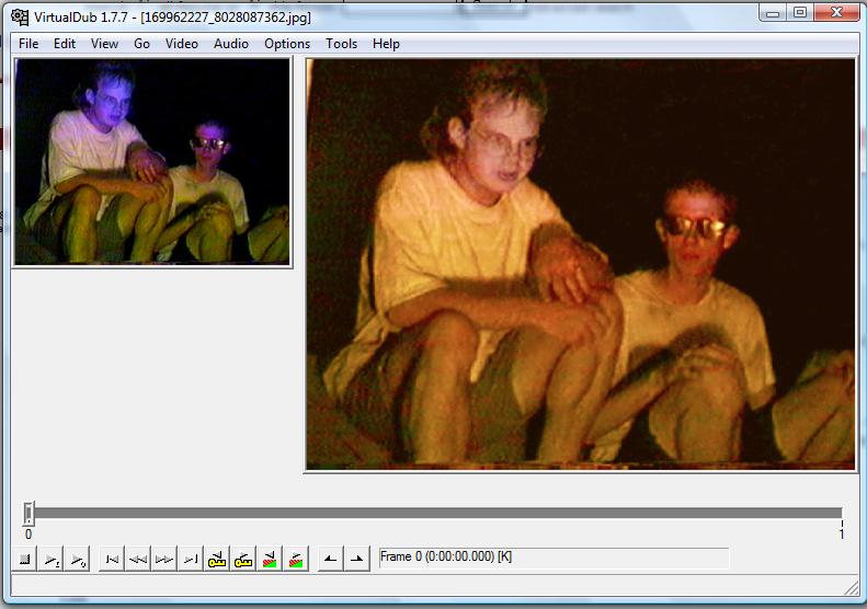

  1. I am currently working on a project to convert an independently produced TV series to DVD.
    Many of the video tapes have heat damage, and I have no access to the master tapes. They are owned by a library, and do not allow access via those means.
    All of my footage is from dubs of those master tapes.
    I currently use Sony Vegas Studio and Photoshop CS3 for my video work, but I am completely out of my territory on this one.
    Here is a screenshot of the damage I am speaking about. I have also attached it.
    Does anyone have any advice on how to attack this?
    Any advice would be appreciated!
    Thanks,
    Lee

    I read that post and found it interesting, but it is dealing with problems with the entire frame. Filters and overlays will change the whole frame, which may correct the damage, but then change the rest. This is my conondrum.

    Your title says "Heat Damaged Digital Video". Digital tape fails into pixelation not what you are showing.
    Are you talking about VHS or which format?
    Also what was the format of the original camcorder master?

  6. The masters were recorded in various formats mainly VHS, 8mm and VHS-C. They are untouchable though, as I said in my original post.
    The dubs I have are VHS, but again those tapes are fine, it's the masters with the problem. The only way I can see to really correct this is with some sort of software solution.
    I'm looking for some advice here regarding how to fix that damage.

    Looks like this with a bit of ColorMill applied:
    But I had to reduce the blue to almost nothing and boost the red to about max. But the 'green legs' aren't much worse.
    Also one frame of video is not a good way to judge the result, unless the problem is exactly the same in every frame. But you can definitely improve it.

    So you are dealing with a Y/C to NTSC composite dub captured to YCbCr.
    Dub over S-Video would have kept Y and C separate improving the odds for color correction without affecting luminance.
    A TBC or frame synchronizer would have improved the original dub. A dub house would have the right equipment.
    As it is, you can play with digital filters but don't expect great results.

    If you could dub from the original tapes again, things could be done. Once the stew is over salted*, recovery is difficult and it won't be the same.
    * i.e. conversion to composite NTSC.
    BTW: Heat didn't destroy that original tape obviously but one side probably got heated more than the other causing warping or stretching on that side of the tape. A playback VCR places even tension on the tape. The stretched portion would show phase (hue) or dropout errors.
