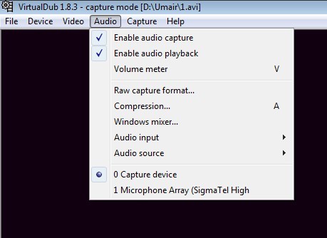

    Sep 2003
    audio tab

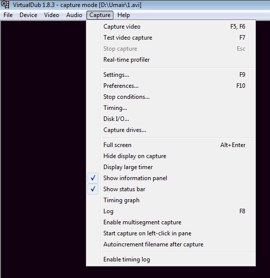

    Sep 2003
    capture tab

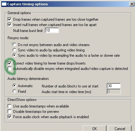

    under capture click on timing
    try varying settings in circled boxes

    Turn off 'Enable audio playback' = No more V-dub sync problems
    Sep 2003
    mgh thanks for the advice but the problem was still there. i appreciate your help though!
    GideonK thanks for the advice. it worked! only drawback is that i cant listen to it while its recording. but it records with no problems. thanks again
