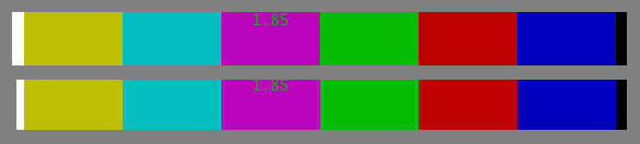

A note to the OP: cropping YUY2 or YV12 at odd boundaries will lead to significant blurring of colors:
That was done to a 720x480 source using the LanczosResize(716, 480, 2, 0, -2, -0) on the top and LanczosResize(716, 480, 1, 0, -3, -0) on the bottom, on a YV12 source. Using BilinearResize() instead was a little better. Of course, this source has unusually sharp edges which makes it much more noticeable. And note, no resizing was performed, just cropping. Converting to RGB first eliminated this problem. -

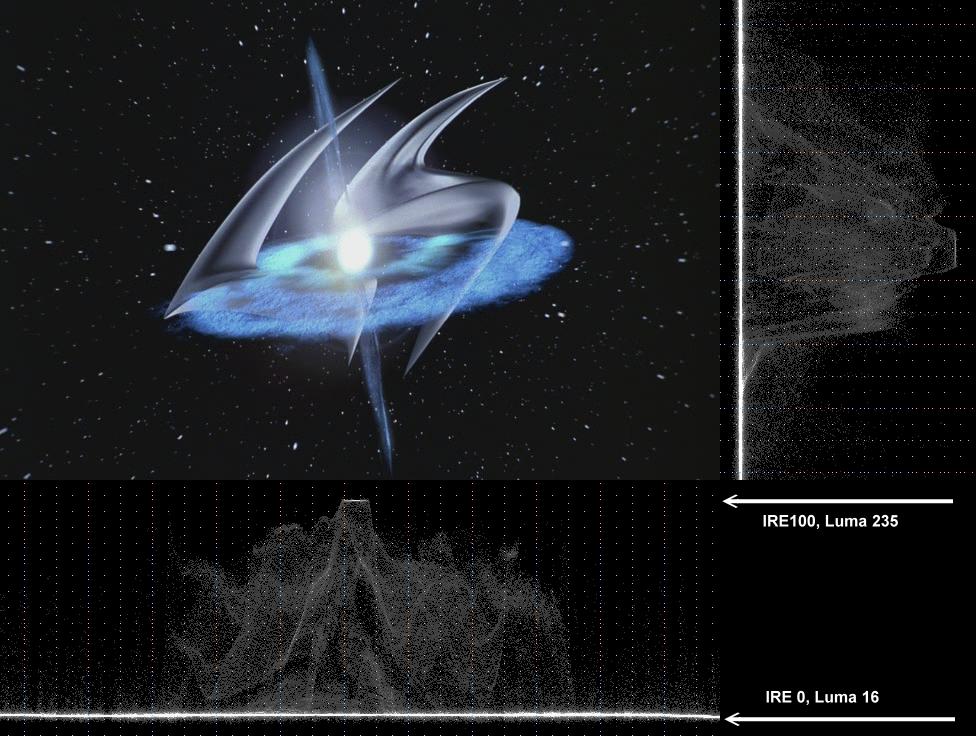

VOB from DVD:
After ConvertToRGB(matrix="PC.601") and MPEG compression with TMPGEnc Plus with 'Output YUV as basic YCbCr':
Black and white levels identical.

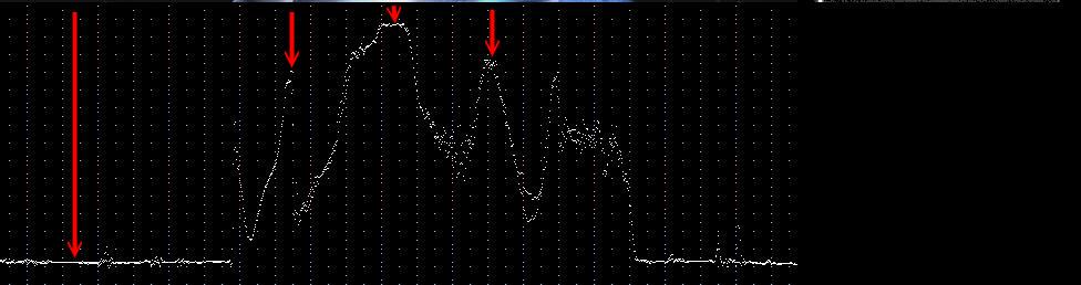

The black of space in the video frame is about luma 20 (also RGB=20 in the images). It should appear nearly black on a properly adjusted TV. Note that it is probably not black on your computer monitor because the luma levels have not been adjusted for viewing on a computer. The black in the VideoScope background is luma 0. If you are adding black borders with AddBorders(...) while working in RGB that is what you are adding. If you see anything more than a barely perceptible difference between the luma 20 and luma 0 on your TV it (the TV) needs adjusting.
The VideoScope graph at the bottom of the images is a graph of brightness (vertically) vs pixel position (horizontally). It might be most easily understood by looking at a single line of pixels (actually 2 in this picture):
At the top of the image are two scanlines taken from the middle of the earlier images. The body of the graph shows the brightness of the pixels across the width of the image. The higher a point is on the graph the brighter that pixel is within the image above. The red arrows show how the bright spots of the image become peaks on the graph, the dark parts on the image become valleys.
