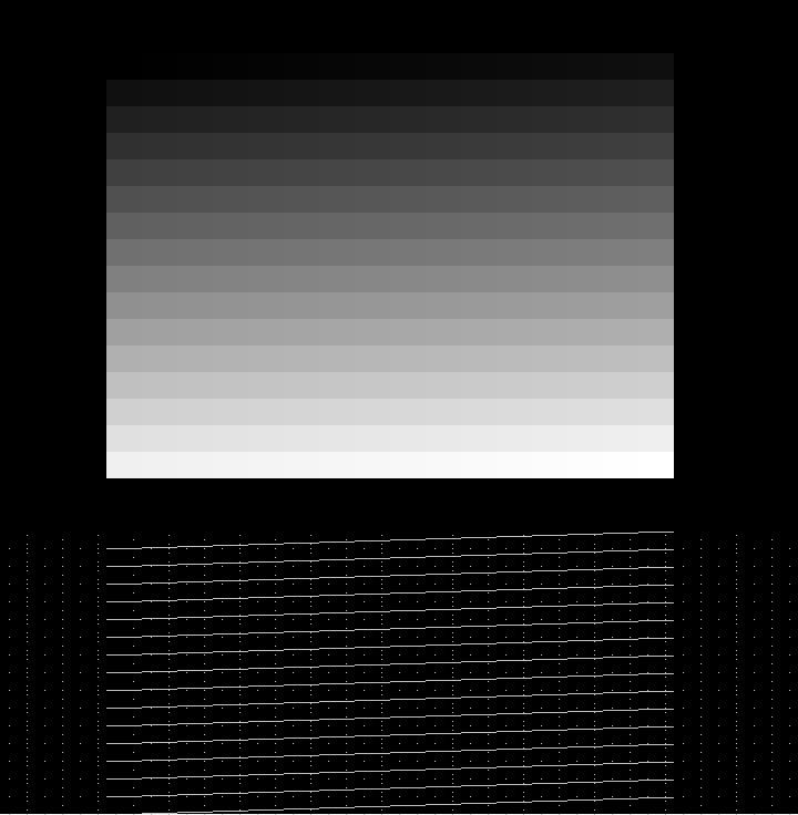

I worked out a way to show that TMPGEnc loses precision when fed YV12. I created an MPEG file with blocks of luma from 0 to 255, all 256 values. If fed to TMPGEnc as RGB (via AviSynth's ConvertToRGB(matrix="PC.601") to preserve the luma range), and encoded with TMPGEnc "Output YUV data as basic YCbCr not CCIR601" setting, the output shows all 256 values with no errors:

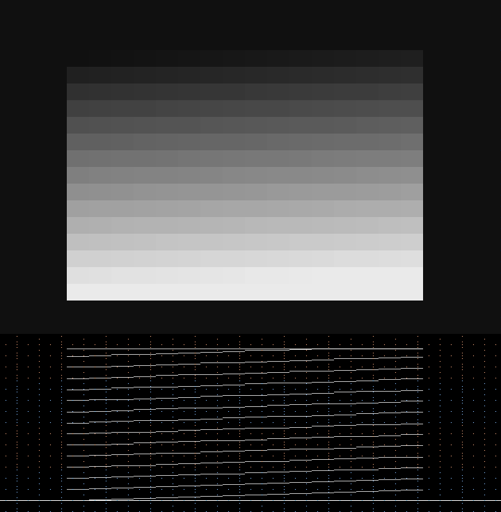

When fed to TMPGEnc as YV12 and using the same "basic YCbCr" settings TMPGEnc does not preserve all 256 luma values:
It has clamped values below 16, above 235, and lost precision in the rest of the range. For example, you can see that the block that should have had a value of 61 has a value of 60, and much of the higher values have shifted down by 1. It does the same with YUY2 input. In a separate similar test CCE retained the full range and lost no precision.
This isn't definitive proof that TMPGEnc converts incoming video to RGB. But given that we know it performs all its filtering in RGB, and that incoming YV12 results in exactly the kind of precision errors that converting YUV to RGB and back to YUV generates, I am satisfied that the program converts YUV sources to to RGB. -
