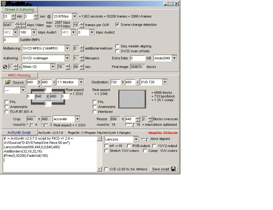

I went through some guides but I get completely lost when it comes to AVISynth or Converting to MPEG04 I believe is the right format.

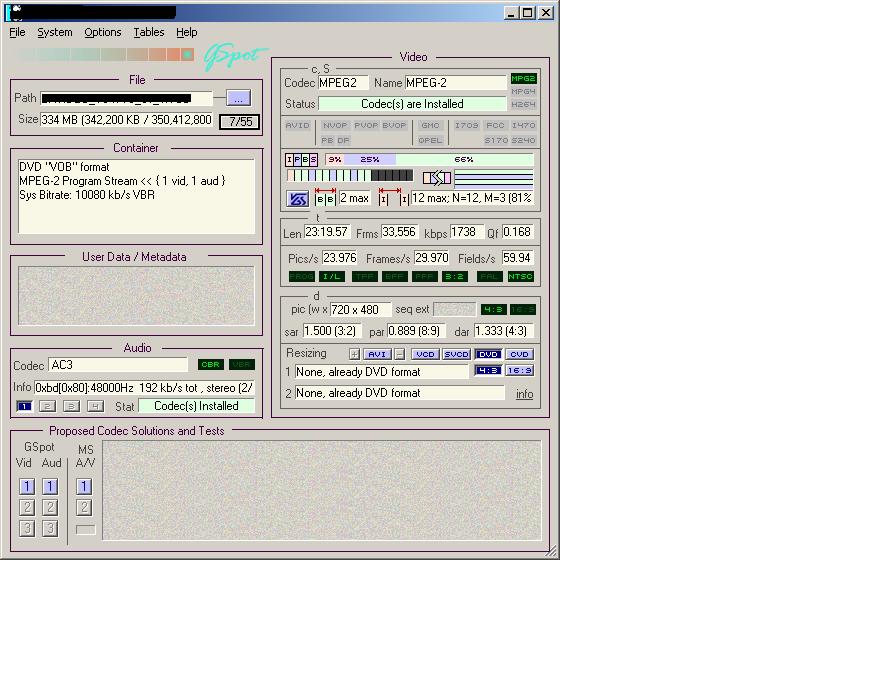

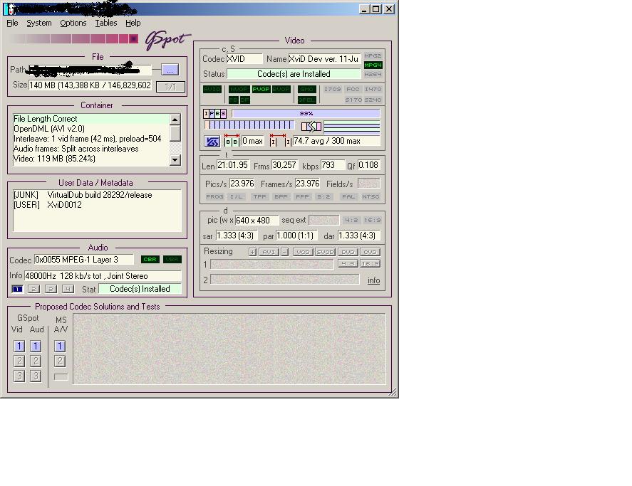

Here is what my AVI's look like in G-Spot 2.7..I also watch my DVDs on a PS2 which is terrible with overscan so I think I needed to convert the AVIs from 4:3 to 16:9..

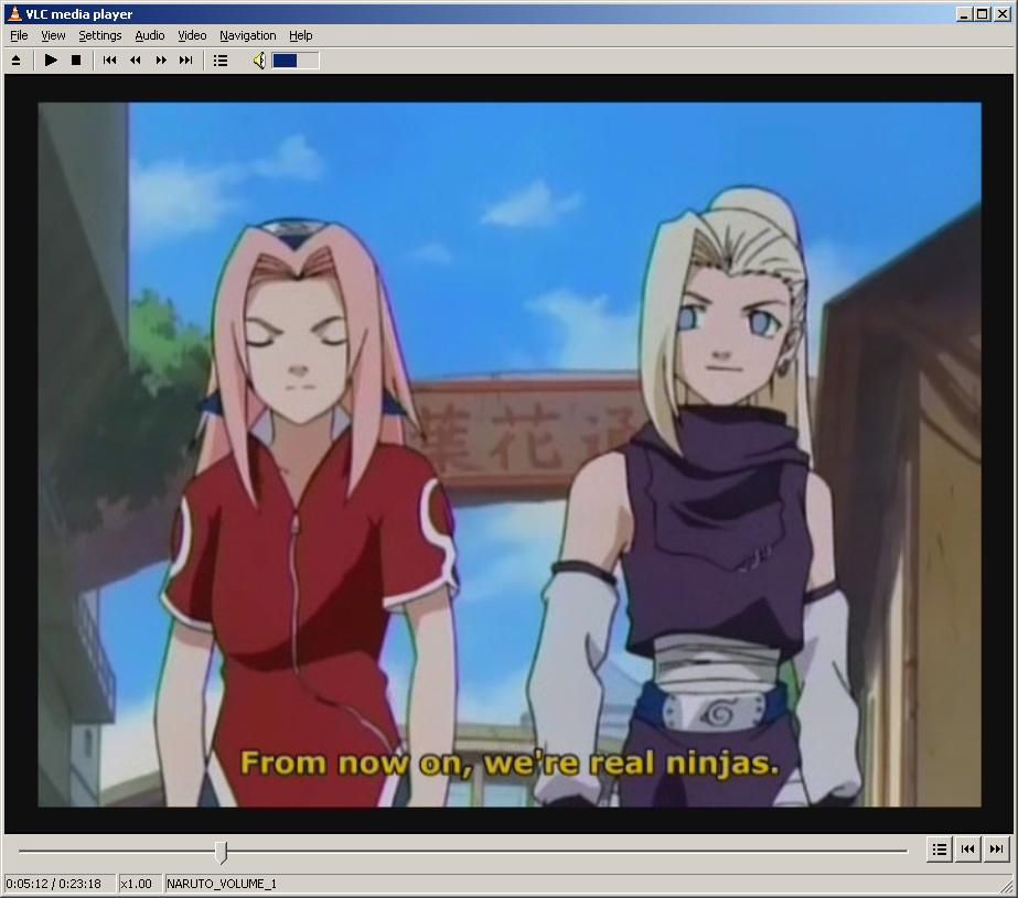

It looks great..I don't notice any difference. It looks great on my 13 in TV...I don't see any pixelation or anything.

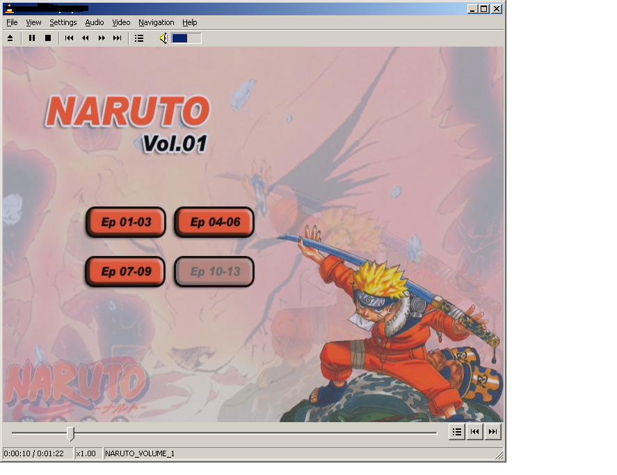

I want to set my DVDs up like this...13 Episodes on a DVD is AWSOME...
he only used 4.24 GB to make this one DVD...
I like the 13 Episodes it makes less Discs.. -

Just burn as a data disk and you can fit ~30 episodes with better quality than converting to DVD
(since your original .avi episodes are ~140MB from the gspot screenshot - but they are already compressed to begin with - you'd do a better job with original source quality material)
Or if you want playable on PS3, convert to h.264/aac in .mp4. You could still fit about 30 episodes.

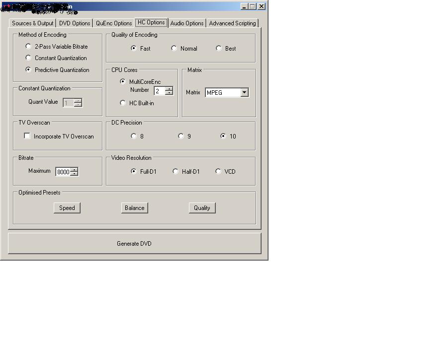

I am using Half D1 for Speed Choice in FAVSC it only takes an Hour to Encode it and it is small on space...I just burned two discs with 8 Episodes each and it is only 1.6GB's I Still have 2.8 GBs left...so it would be nice to have a Menu with 10 Episodes or 12...
Please Explain.how to do it? -
Continue to use FAVC, choose half-D1 or even VCD if you must put more than 3 hours on a disc, and tick the TV Overscan box on the HC Options tab.
If you want better menu options then use ConvertXtoDVD instead. You can still accommodate overscan and (I believe in version 3) half-D1, but you have a little more flexibility with menus.
Or let FAVC do it's thing without creating menus. Tick the box marked Keep Working Files, then use the streams it creates to author a disc with menus how you want them using GUIForDVDAuthor.
