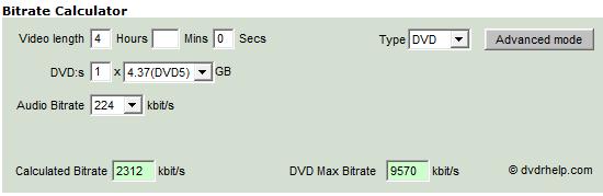

But if you want four hours to fit on a DVD... And I don't believe you mentioned that number before... This from a bitrate calculator:
About 2300Kbs will get you there with a 4.37Gb file size with a bit of room to spare. At that bitrate, 1/2D1 would still be a good choice, as that is at the bottom of full D1 quality. You can use variable bitrate encodes, but you will need to make two passes to get close to that target bitrate. VHS caps often have a lot of noise, so I would try a short encode of a representative sample of about 5 - 10 minutes of your video and see if the results are acceptable. -
