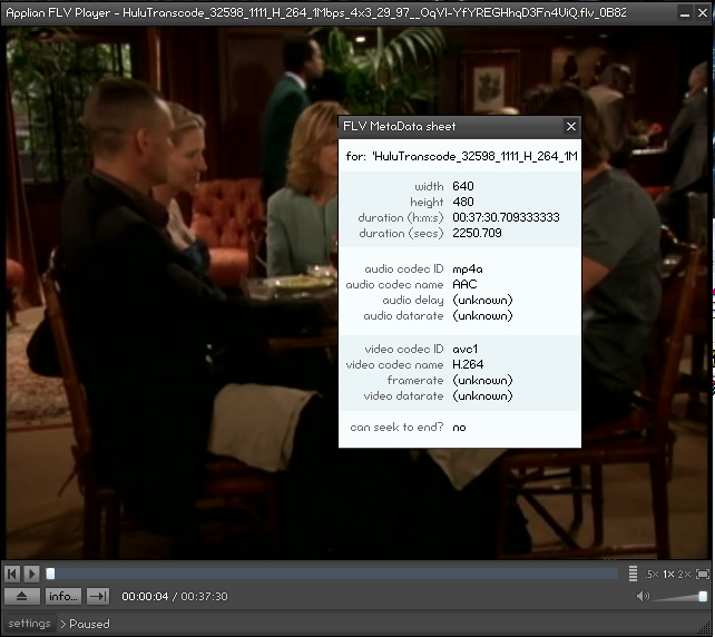

No luck. Im enclosing a jepg of the metadata from the file im trying to use. This is the only player that ive found will play these.

In installed the free demo of Replay Media Catcher on an XP VM and found that it does indeed "capture" FLV as it is streamed from Hulu.com. The 360p files can be played by any FLV player but the 480p files appear to be a slightly different format (the header starts with the same "FLV" but the other metadata fields are more extensive). It appears that most FLV players don't know how to deal with this new FLV format. You'll have to wait until the players have been updated or a new FLV splitter is available.
