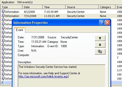

Like the topic says...COMPLETE system lockup...nothing except reset/power button responds.We're sorry There is no additional information about this issue in the Error and Event Log Messages or Knowledge Base databases at this time. You can use the links in the Support area to determine whether any additional information might be available elsewhere.
Event Viewer shows (Windows) Security Center as the last "event" before the lockup.
At first the event was (I thought) tied to Norton(I only had Ghost 9.0 on the computer) since
a Norton Ghost event was recorded at virtually the same time....I uninstalled Ghost (properly with
Norton removal tool) and the lockup still occurs without any mention of Ghost.
Anyone have any knowledge of this one?
Any ideas?
I'm using Avast Home with the standard Windows firewall.

the log shows Security Center - I.D. 1800 when it does lock up?
The exact same time on the Security Center - I.D. 1800 log is the exact same time of the computer lockup....every time.
I don't need surgery....I'm asking if someone else has ever had this type of hangnail.
That was also painfully and clearly spelled out in the very first post:
Anyone have any knowledge of this one? -

imho, you got a virus/trojan as error seems to be from something other than the security center. -
Sorry....
That is not the same "source" as my event.
My source is and always has been Security Center...not RPC. -
