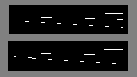

Swap fields doesn't remove interlacing. It only swaps the position of pairs of scanlines. Instead of getting scanlines 0, 1, 2, 3, 4, 5, 6, 7... from the top down, you get 1, 0, 3, 2, 5, 4, 7, 6... This is there for one reason only: to work around a bug in some old capture card drivers. Those cards have not been manufactured for 10 years.Originally Posted by sirsad
The top image shows three slightly diagonal lines. The bottom image shows how the old buggy capture cards captured them. The swap fields function simply converts one to the other. So if you use it on a normal image you get a messed up image.
This is what was wrong with the motionless text in your sample image. I was able to fix the text by applying the swap fields filter in VirtualDub.
