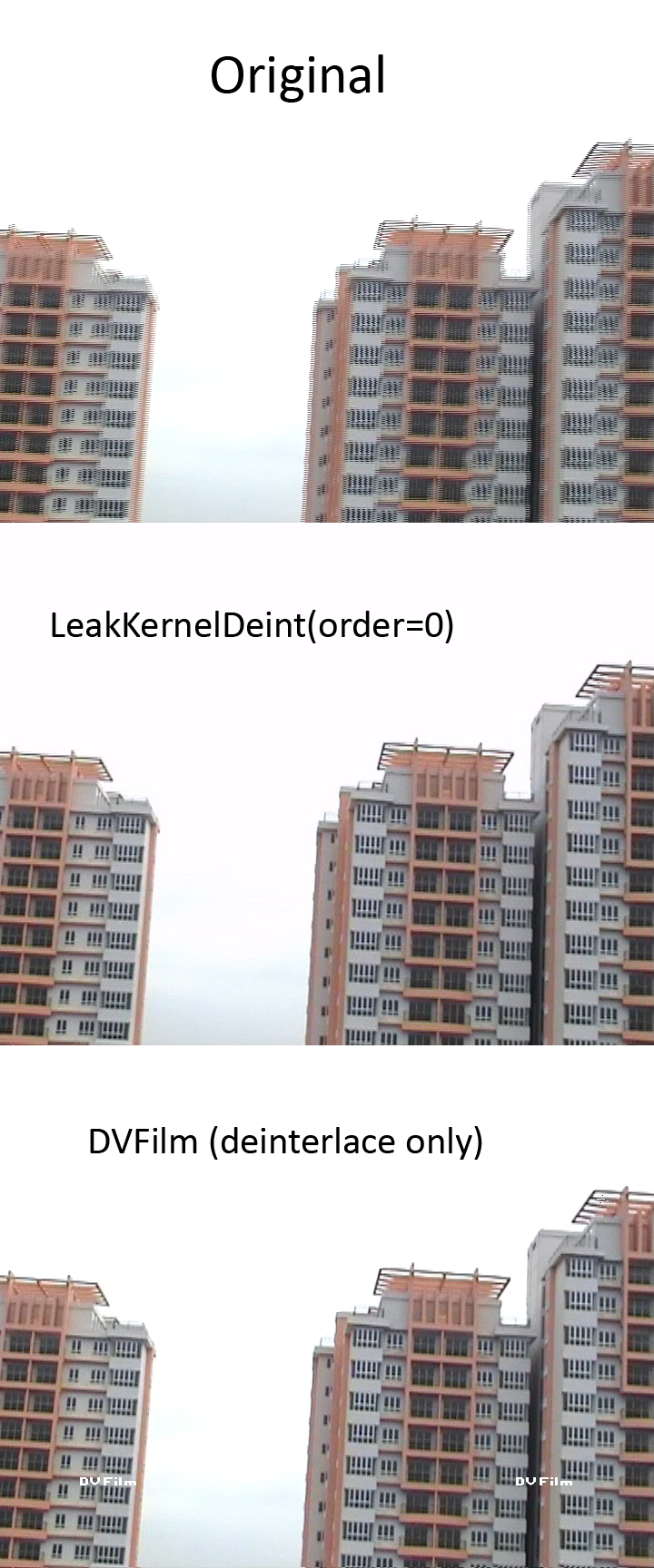

    Hi all.
    i was been desperately looking for tips and news about De-Interlacing methods and best techniques.. for a very long..
    at last i found out very good tips for you all.
    the tip is not my technique at all.. it's been practicing by almost all of the DV people out there.
    What i found out is the comparison result with very popular software DVFilm Maker..
    I hope everybody know DVFilm Maker.. which convert video to Film Style effect and progressive frames..
    Before.. i used Smart DeInterlacer for VirtualDub. It work in it's way. but some artifacts annoys me. and sometime the look of water painted picture make me disappointed. I was looking for and asking help for Avisynth deinterlacing in a post and got 3 kind of methods using LeakKernelDeint , Yadif and TDeint .. i intensively tested those 3 new interlacer ( for me New.. Not for u ) and i found LeakKernelDeint filter very great.
    i am still curious about it's quality as before. and so , I douwnload DVFilm Maker demo software and try to DeInterlace with it.
    and Guess What!!!!!!
    LeakKernelDeint's DeInterlaced video is exactly the same picture quality as DVFilm Maker's Deinterlaced Video (Without any pull down or any other, Just DeInterlaced as my research here is about Deinterlacing),,,
    So, any body out there still looking for Deinterlacing.. i suggest using LeakKernelDeint will be the good choice...
    the script i used as follow
    AVISource("clip2.avi")
    //ConvertToRGB32()
    LeakKernelDeint(order=0)
    I did ConvertToRGB32() because, i am using Panasonic DV codec and it only support 16 and 24 bit. but LeakKernalDeint require RGB32 at least. Try to use the script without ConvertToRGB32() first, only if you cant process, use RGB32 convertion.
    Do not add sharperning in LeakKernelDeint as it will add some artifacts. just use smart blur in vdub and punch up saturation about 130% and after that add Sharp filter in vdub. with will give you better result.
    The Best Part Is !!!! when saving deinterlaced video from Avisynth using LeakKernelDeint by using VirtualDub with Panasonic DV codec is running 31 fps rate while DVFilm is saving with around 12 fps...
    can you believe it.... wow!
    Thanks to manono and jagabo who suggested me for these avisynth filters.
    the following images shows the comparison results. do not be fooled by the little changes in brightness. it was make by video player software after i captured the frame images.. dont know why..
  2. What did the source look like? And you can't really judge deinterlacing algorithms by looking at a single frame.

    hi. jagabo.
    i have updated the image with original, Leak and DVFilm maker...take a look
    i have tested on 10 min of my DV footage with lots of scene changes and movements.
    the result from DVFilm maker and LeakKernelDeint is same. and overall the whole footage result from both is same and really good.

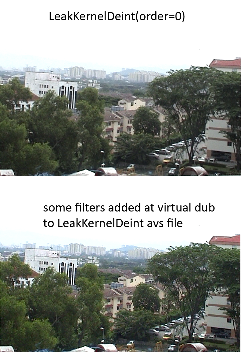

    After enhancing LeakKernelDeint(order=0) Deinterlaced avs file with VirtualDub filters..
    i got the following comparison.
    Click here to see Comparison Images
  8. I'm glad you're getting good results, but you can do as well or better using all AviSynth filters (including saturating and sharpening). Almost anything you can do in VDub, AviSynth has an equivalent filter for. And AviSynth can do a lot for which VDub has no equivalent.

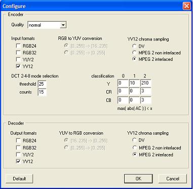

    ok. here is the new problem
    after DV footage was captured, it was YUV12 color space is it?
    So, i want Cedocida DV codec to force to decode the DV footage with YUV12 so that not to lose any data.
    So, i force it in VirtualDub using compression dialog box. after i open and add some filters in Avisynth, i can not open that script on VirtualDub.. why??
    and why cant i force decoder setting's YUV chroma to DV instead of MPEG2 interlace??
    what is the best work flow.. please tell me.

    i have figured it out some how..
    like this.
    I configure that dv codec to only use YUV2 for both in and ouput..
    and i load video in avisynth script, and deinterlaced it..
    then load into virtualdub.. and Input window of virtualdub show all blue colored and noises.. but, output window seems OK..
    BTW. why Decode section of Cedocida can not set to DV under chroma sampling??
    the following image is my setting. after i set to DV. the colors are overlapped..

  15. I've only used Cedocida for NTSC DV. It uses 4:1:1 chroma subsampling so I have the YV12 options disabled. That's the safest way to use the codec as VirtualDub doesn't handle interlaced YV12 very well (it treats it as progressive YV12).

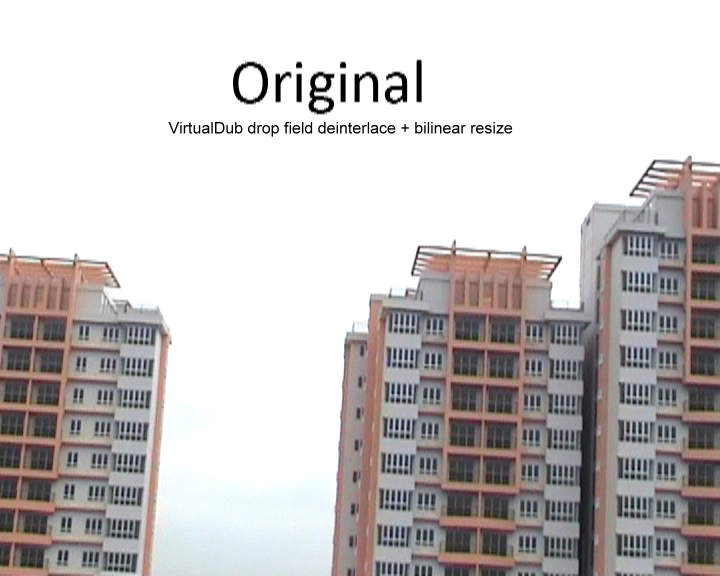

  16. I'm not convinced DVFilm Maker is doing such a good job. Here's your interlaced DV frame deinterlaced by VirtualDub by dropping one field (Discard Field 1 in VirtualDub's built in deinterlace filter) and resizing what's left with a simple bilinear filter:
    This is one of the poorest deinterlacing methods but looks about the same as DVFilm Maker. Note that the type of scene in this image is among the hardest for software to deinterlace. So smart deinterlacers may not do much better than this simple one.

  17. Originally Posted by tinkyawoo
    I would say your VirtualDub processed image is over sharpened. Look at the jagged diagonal edges of the rooftops. These are going to buzz annoyingly at normal playback speed. The sharpening has also created lots of overshoot halos at sharp high contrast edges. These will likely be exacerbated by additional sharpening by a DVD player and TV.

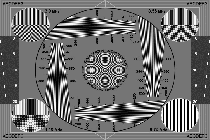

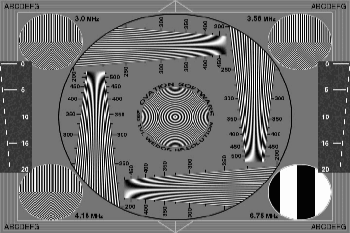

    There definitely is a difference between discarding a field and smart deinterlacers with static scenes. It's most obvious with resolution test patterns but if you know what to look for you will see it in normal material. The sharper your source the more obvious the artifacts will be.
    A resolution test pattern:
    After discard field and bilinear resize:
    I was going to post the same pattern after Donald Graft's Smart Deinterlace filter for VirtualDub but it was identical to the source (the top image).

    my new test with your test pattern.
    1. imported to premiere, and make moving pattern, Exported to DV NTSC avi file.
    2. use premiere to VirtualDub, discard Field 2, resized to 720x480(original size) with cubic interpolation
    3. use premiere to AviSynth , LeakKernelDeint order=0 , and save to DV with VirtualDub without filters...
    after watching 2 resulted avi files. LeakKernel is nothing better then simply discarding field 2 and resizing back to normal..
    why? am i doing something wrong or, Kernel deinterlacing is simply idiot?
    Note** smart deinterlace by Donald Graft is nothing better then LeakKernelDeint
