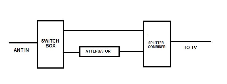

	Single channel UHF attenuators won't be cheap.  If you don't mind the cabling, you could just get a switch box and use a inexpensive untuned attenuator and switch it in when viewing that one channel. Feed the two outputs into a splitter to combine them back to a single line for the display device. The splitter will cause some loss, but should be tolerable. Just one suggestion. If you don't mind the cabling, you could just get a switch box and use a inexpensive untuned attenuator and switch it in when viewing that one channel. Feed the two outputs into a splitter to combine them back to a single line for the display device. The splitter will cause some loss, but should be tolerable. Just one suggestion.
	OK, I guess I didn't explain my goals very well, so let me paint a broader picture. In addition to wanting to be able to watch both the weakest and strongest channels at the same time, I want the MyHD MDP130 to be able to tune in all of the channels without manual intervention.
 For example:
 I want to use the MyHD MDP130 to timeshift two programs while I'm out one night. The first program I want to capture is on the weakest channel. It starts at 7:00pm and runs for an hour. The second program is on the strongest channel starting at 9:00pm, it also runs for an hour. Obviously any solution with a manual switch will not work because I won't be there.
 I want to somewhat balance the signal strength of the various channels so that all of the channels are visible to all of the tuner devices in the house without having to make any changes to the antenna system.
 To further complicate this, I'm finding it hard to understand what frequencies I'll need to attenuate. Apparently, the channel number given in the description from the station is not necessarily the same as the channel number that defines the frequency range. Maybe someone more knowledgeable than me can shed some light on this?"Shut up Wesley!" -- Captain Jean-Luc Picard
