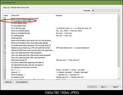

  8. Open subtitle in Subtitle Edit
    select Tools -> Fix common errors -> Fix overlapping display times
