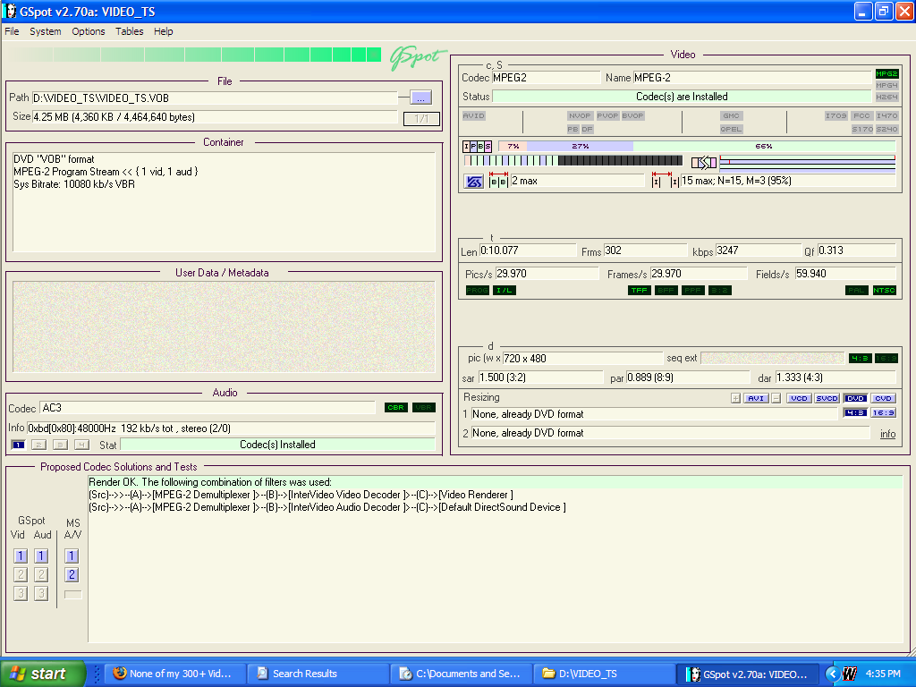

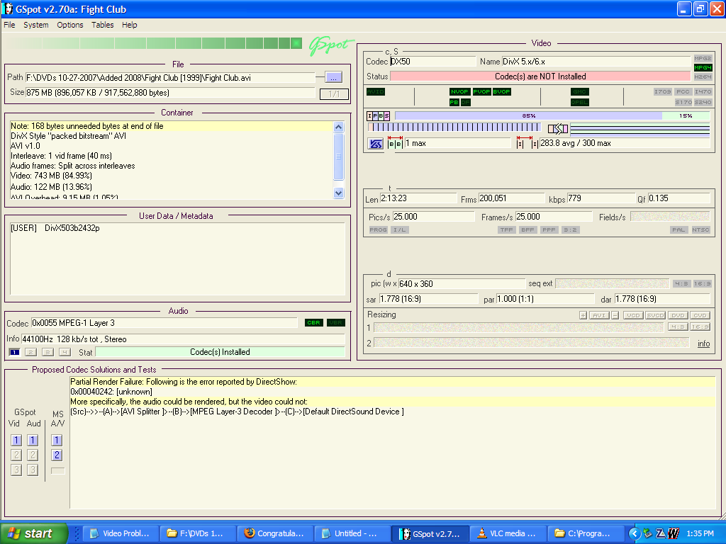

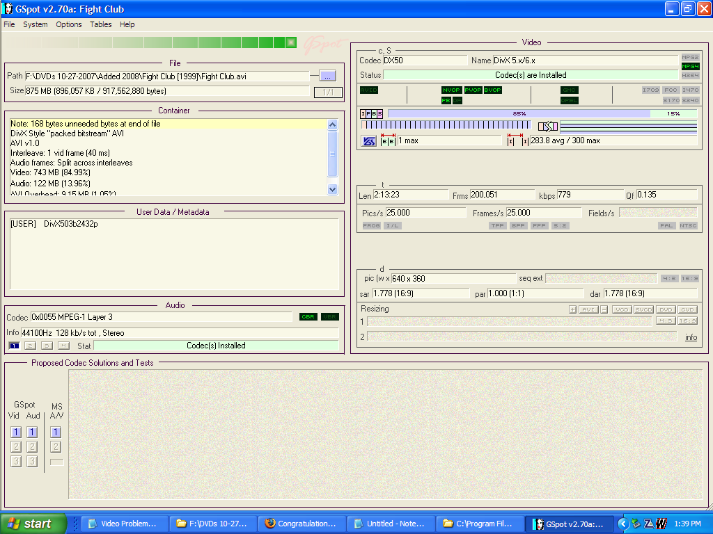

Ok Bjs, I've performed all the steps you recommended. I've attached images that will hopefully help to diagnose the problem. I'm sorry there's so much data but I was criticized for not including enough detail so I thought it was better to provide everything I have. If there is additional information needed, please let me know and I will get it. THANK YOU again for all your help.
After running the DXdiag, I dropped a file into GSpot and analyzed it. The first image shows the error due to the fact that I had uninstalled FFDShow. I then only installed the DX50 CODEC which GSpot said was required as per your instructions and ran the same file through again. You will notice that in the second image there is no CODEC error and the file appears to be fine. Finally, I tried to play the movie using various players including VLC where I got only audio but no video. If anybody could help me, I would sure appreciate it. It's been a difficult problem for me.

gspot%20error%20snapshot.bmp -
Since the forum would not let me post more than one image, here is the second GSpot screen after I installed the correct driver for the file. Thanks!
gspot%20snapshot.bmp -

Hi Merlin. Mplayer says it's for Linux systems and looks like it's for very advanced users. I don't mind trying it if it's as simple as downloading it, installing it and dropping a movie file into it but from the information I read on their site it looks much more complex than that. Is it? My other hesitation is the issue of installing additional CODECS since it looks like that often causes more problem than it solves. What are your thoughts on this?
Lordsmurf, below is a snapshot of a VOB file analyzed by GSpot. All I can tell from it is that the file is using MPEG2. But please tell me what you see that I might be missing. I did answer your question about the CODEC packs. In fact, I asked a question related to your topic because I thought it was a good point. The bottom line in case you don't want to go back and read what I wrote (which is posted directly under your question by the way) is that I have not installed any other packs. I had FFDShow which I removed based on advice received here and then I installed only the CODEC GSpot identified as necessary for running my test file. Thanks for your feedback.
gspot%20vob%20file.bmp -
