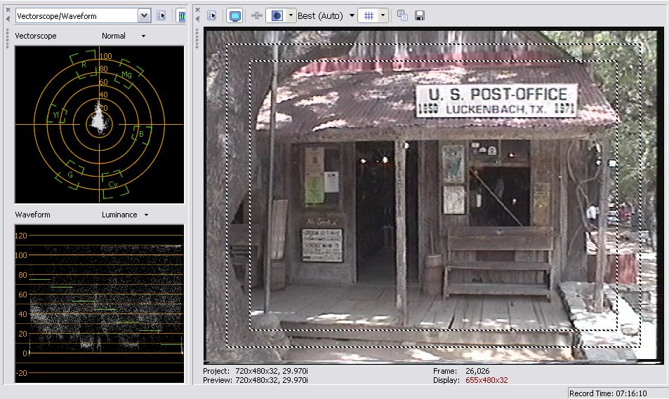

    All normal. The head switch line exists on all Video8, Hi8 and VHS. It's usually hidden by TV overscan. Some overlay a mask to hide it.
    Video8 example
