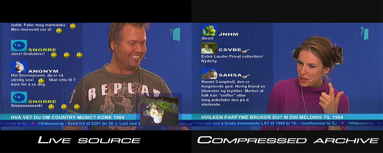

You'll find a jpg here with a side-by-side comparison of the videostream I'm recording, and the result I'm getting so far.
