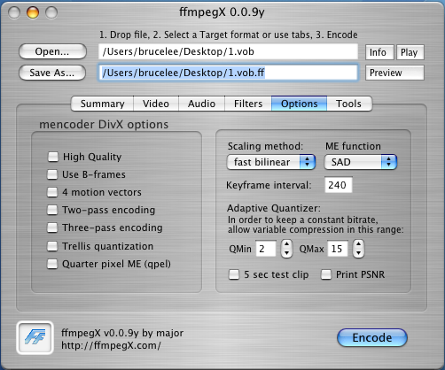

	by fuzziness i mean person thats in motion is fuzzy around the body parts in motion, i've already cranked up the bitrate to as much as 11000 and also checked the High Quality button in the options tap & although the picture had more clarity and the fuzziness was still apparent

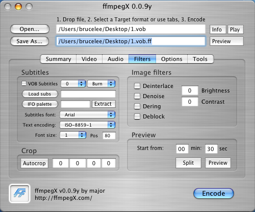

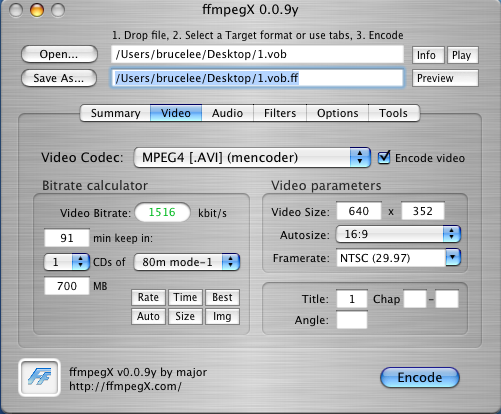

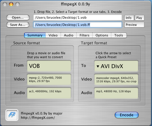

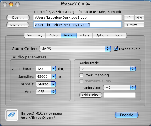

 these are my conversion window i've left everything standard but i do change the bitrate but for this example i left it normal
	Your source video is interlaced. I'll bet that is causing the fuzzy moving edges in your (progressive) output. Try the de-interlace image filter.Originally Posted by BassJunkie

 In addition to the interlace issue that Case refers to, another thing to note is that the source and target resolutions are different. That means that a scaling operation has to take place to convert one into the other. That scaling operation can introduce fuzziness of a sort, and it can be more noticeable during motion than at other times. As you've noticed, simply upping the bitrate hasn't solved your problem. If de-interlacing doesn't take care of what you're objecting to, read on. Otherwise, ignore.
