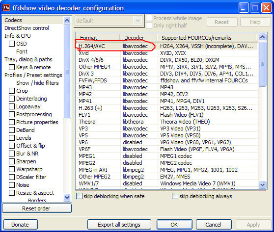

"Turn on" the appropriate video codec in the ffdshow vfw interface configuration, and the normal (non-vfw) configuration. If you don't know what codec is being used, run mediainfo on your video

Run mediainfo on your file, what codec is being used? Then turn on the appropriate one in the ffdshow configuration. For example, if it was h.264 it would look something like this

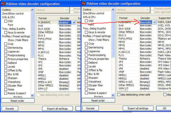

To turn it on, there is a drop down menu, switch it from disabled to libavcodec (like in the screenshot)
1. I selected something of libavcodec because that was the only option besides disable(d)Originally Posted by poisondeathray
2.No it still closes every time I try to play it

It's in the screen shots, from "disabled" to "libavcodec"
