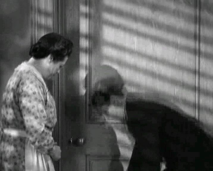

Recently I downloaded a DVD from the internet, which makes me wonder what's wrong with it.
These are 4 subsequent frames as shown by VirtualDubMod:
And this is what Gspot has to say about the VOB-file:
Can anyone tell me what's going on here?
And more importantly: Is there anyway to correct this?

Someone resized and converted a telecined NTSC video to PAL incorrectly.Originally Posted by Ruut

No, I was able to view your images by cutting and pasting the links that weren't working.
Someone who didn't know what they were doing took an telecined NTSC video and converted it to PAL. When resizing the frame from 720x480 to 720x576 they didn't account for the fact that many of the frames were interlaced. I can't tell from four still images but they probably didn't do a good job of the frame rate conversion either.
You could try running the video through a blend deinterlace which would reduce the comb artifacts but the frames would still look like double exposures. Your second image after a blend deinterlace:
There's one other possibility: maybe the mixing of the two fields was caused by the way you prepared your stills. But given their size, ~720x576, I think this isn't the case. -

Yes, it's as I originally guessed: incorrectly resized from a telecined NTSC video. There's not much you can do.
Sure does, and proves that jagabo was on the money when he says an improper resize was done on it. You have interlaced fields here, and that's never supposed to happen. And both fields of the interlaced frames are interlaced. This conversion was done by an incompetent moron. And this is a retail DVD, isn't it?Does that clarify the problem?
As he also said, you can deinterlace it to get rid of most the combing, but nothing will be able to get rid of the blends/ghosts/double images.

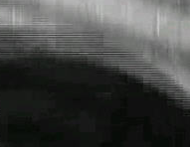

It was an easy deduction. The combing had a very distinct pattern of clear/fuzzy from top to bottom. A 2x nearest neighbor enlargement:
This is a sign that interlaced video was resized improperly. And since some of the frames had comb artifact and some didn't (and all four appeared to be frames where there was movement) it was obvious that NTSC telecined film was involved. -

You can't do any kind of smart deinterlace because the two fields are no longer separate. All you can do is blur the two fields together (aka blend deinterlace) to reduce the comb artifacts -- at the cost of a blurier image, the frames looking like double exposures, and another round of MPEG compression artifacts.
It's not clear to me that the result will look any better than the original. If you're going to try this you might as well run a deblocking filter too. The video is full of macroblock artifacts.
