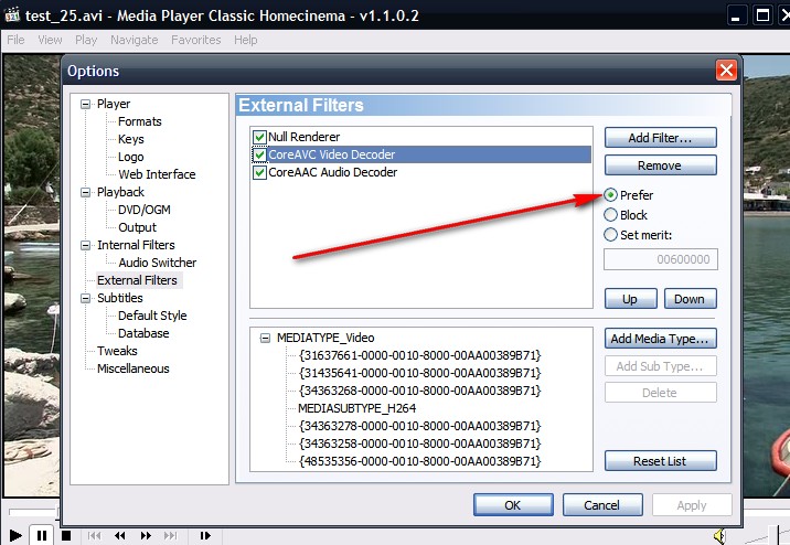

Maybe the Sony codec has higher merit than CoreAVC (I'm guessing). I think CoreAVC needs Haali if I'm not mistaken. You can also try to raise the merit of CoreAVC with MediaPlayerClassic under the options settings:
Still no go, I used media player, when I went to external filters, their was nothing listed, I could add one but their was a list of about 40 filters, I have attached the filters maybe you guys can help me decifer which one is being used for avchd?
