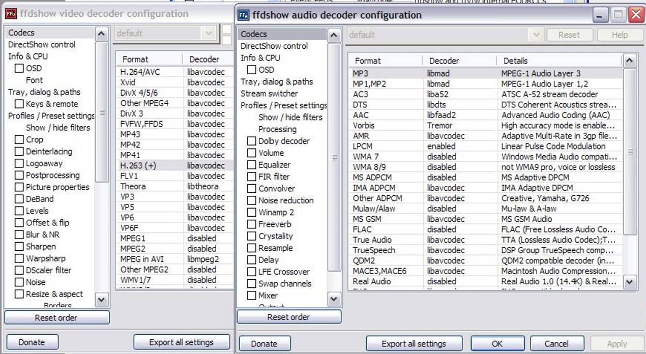

	I have a blue and a red icon, so I'm assuming you mean the blue icon?
 I took a screenshot but I don't see a way to attach a picture here.
 What is toggling?

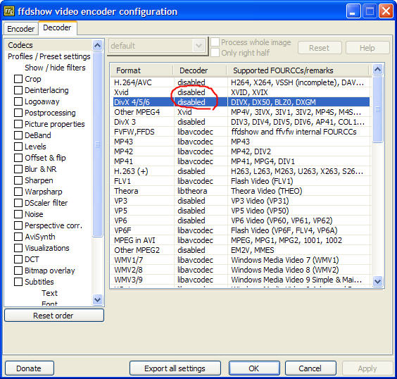

 What am I supposed to do with the xvid and divx that you circled?[/img]
	If you don't have a gold/brown colored one (the VFW one like my original screenshot), then you won't be able to do this in vdub
 vdub uses this outdated VFW interface, unfortunately.
 You should be able to get around this problem by using avisynth scripts (since you have the regular 64-bit ffdshow installed). But then you have to learn how to use avisynth to frameserve into vdub (worthwile endeavour IMO)
 I can 100% guarantee that it won't work in vdub directly without the vfw interface enabled
