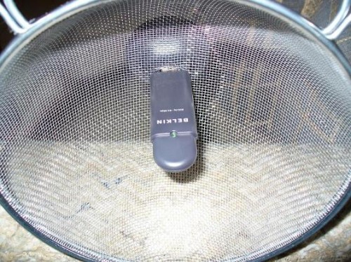

 A USB adapter on a cable, combined with some tinfoil in a dish shape, blew a $40 antenna plus PCI card into the weeds.
	A cheap way to extend wifi range using a kitchen strainer as a parabloic reflector. Some have tuned these for miles of range. It needs to be pointed at the wireless router.
 http://images.google.com/imgres?imgurl=http://hackedgadgets.com/wp-content/usb%2520wif...%3Den%26sa%3DN
 Better yet Chinese parabolic fry strainer.

	Wow, that looks a lot like how you catch signals with a satellite dish. interesting, thanks!
	Same principle. You focus the beam for longer distance. If you focus too tight pointing becomes difficult.Originally Posted by vipertongnRecommends: Kiva.org - Loans that change lives.
