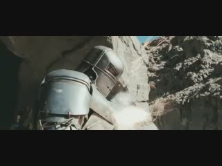

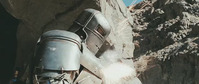

    The 1st is from the IronMan apple trailer at 640x272. The DAR is 2.35
    The 2nd is redone as if it were for and IPOD. Absolutely rediculous watching it.

    no offense but that second picture doesn't look to bad at all! I wish my AVI looked like that! at least its widescreen
  8. None taken! If it's ok for your tastes , then fine.
