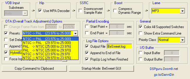

I will try besweet and convert the ntsc .wav into a pal .wav to see if the fps match when I load into vdub.

now I tried besweet to convert ntsc 29.970 to pal 25.000 using the preset option, the end result was a .wav file with a longer running time and slow down audio.

Edit: I just read in another post to use the 23.976 to 25fps preset in besweet, will try that and update.
oh my god, it actually worked! yes!! now to cut and edit the clip. Thanks alot guys. -
I think I got overly excited in that last post, it didnt quite work right. Strange how when i saved it as mp3 in besweet it shows up as 25fps but if i save it as .wav it goes off.
