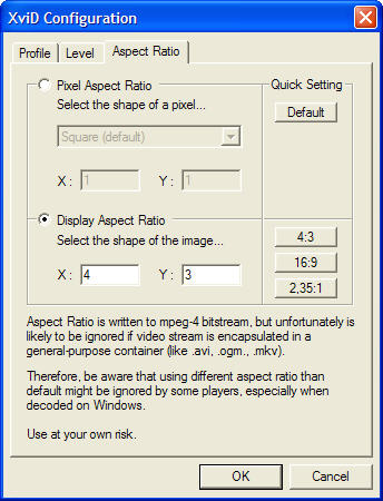

  4. I know this doesn't answer your question directly,
    But in for XviD in Vdub you can adjust the PAR and DAR quite easily.
    You can also use MPEG4Modifier to change PAR, DAR without re-encoding
    Cheers

    Thanks, poisondeathray, those PAR settings in VDub were exactly what I had in my head when I started this, but I much prefer using FFmpeg (it's so much faster than VDub and I feel like I can control output quality a little more easily) -- so, basically, I'm looking for the equivalent setting in FFmpeg.
    MPEG4 Modifier is a great utility too, for a quick fix, but I'm afraid the stuff I'm doing here requires re-encoding.
    Thanks again.
  7. Member PBear's Avatar
    San Francisco Bay Area
    poisondeathray: Jeez, sometimes I'm a little slow on the uptake ( ) ... changing Pixel AR (not Display AR) to "4:3 NTSC" in MPEG4 Modifier on the output file works like a charm (720x480 AVI is resized by DVD player to fit my TV screen fully). It's an extra step, but it works. If I can just find some way to set that in FFmpeg, then I can eliminate the extra step.
