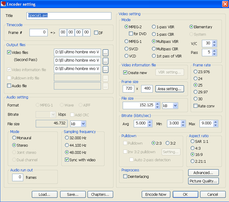

    CCE settings

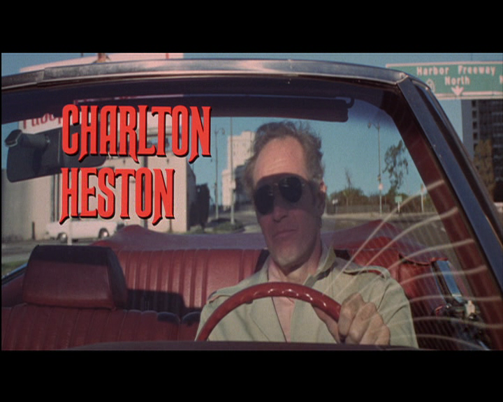

    Comparison images (updated images - same frame)

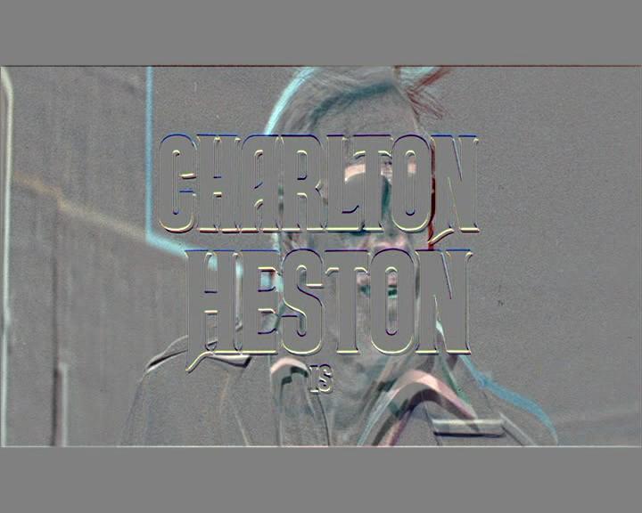

  2. It would help if you posted the exact same frame from both videos.
    I resized the NTSC frame to make it the same size as the PAL frame then used AviSynth to to compare the two images. Except for the places where something is in a different place the colors differed by only a few units. That amount is common any time you recompress a video. And it is common for any two nearby frames to differ by that much.
    v1 = ImageSource("p.bmp")
    v2 = ImageSource("n.bmp").BilinearResize(720,576)
    sub = v1.subtract(v2)
    substrong = sub.levels(112,1,144,0,255)
    return(\
    StackVertical(StackHorizontal(v1.subtitle("PAL"),v2.subtitle("NTSC")),\
    StackHorizontal(sub.subtitle("Difference"),substrong.subtitle("Difference amplified"))))
    Where the two videos match exactly is medium gray (RGB = 128,128,128). Where they differ will be different from that shade of gray by the amount they differ. For example, if one image had 64,64,64 and the other had 64,65,66 the diff would be 128,129,130. Mathematically it's 128+A-B.
    Most of the differences in the above pic are because the two images aren't from the same frame. But if you look in areas where things haven't moved the pixels are mostly 128,128,128 or very near that.

    I have updated the screenshots to reflect the same frames....
    I understand what you mean, but the color fading is occuring just in this particular movie.
    Both other movies I have encoded, (also progressive) have the same color, making it impossible to tell the difference between them.
    What I do not understand is why this particular movie have the color washed away... Could it be a Interlaced and Progressive source ?

  4. There is no significant color change between the two images. I resized the PAL image to make it the same size as the NTSC image, added the letters N and P to top left corner, and made them into an animated GIF:
    I don't see any significant differences.
