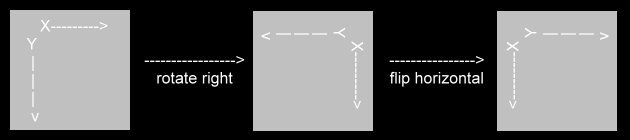

Flipping (diagonally) or rotating a matrix converts frequency domain of the X axis to frequency domain of the Y axis, and vice versa. Then you rearrange the blocks so they're in the right place.Originally Posted by mpack

After rotating right by 90 degrees the elements are reversed along the (new) X axis. So flip the matrix horizontally:
Of course, this is equivalent to flipping along the diagonal.
Then, if this was the top left block, move it to the top right to rotate its overall position. -
