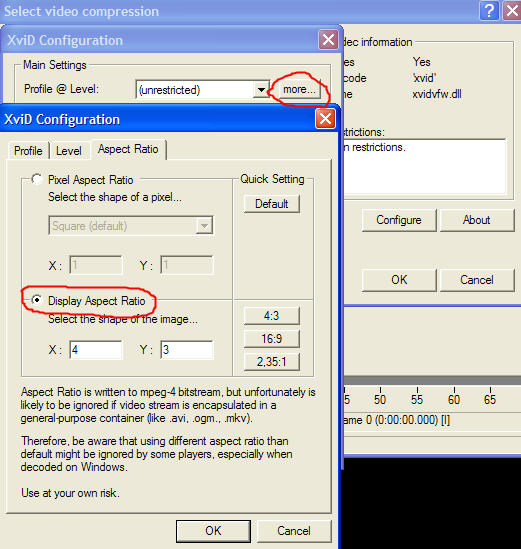

One more question. I didn't see a place to specify DAR for the Xvid codec. How would I do that? I still haven't decided between DivX and Xvid so I'm experimenting with both...
