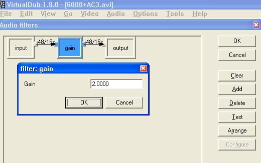

OK I'll do all that from now! SORRY and thanks for your help!!...So I do find the volume in VirtualDubMod but then I got a "Adjust volume to audio channels" where I can change % (see picture)...is it where you mean I shall boost the audio by 10dB?Originally Posted by jagabo
when I use the advanced filtering instead my sound is wrong as before (to low (the volume isn't to low but the sound frequency))Originally Posted by jagabo
cheers

Oh sorry, VirtualDubMod doesn't give the volume increase in dB, it uses percent (the current version of VirtualDub uses dB). I think 400 percent is the right value there.

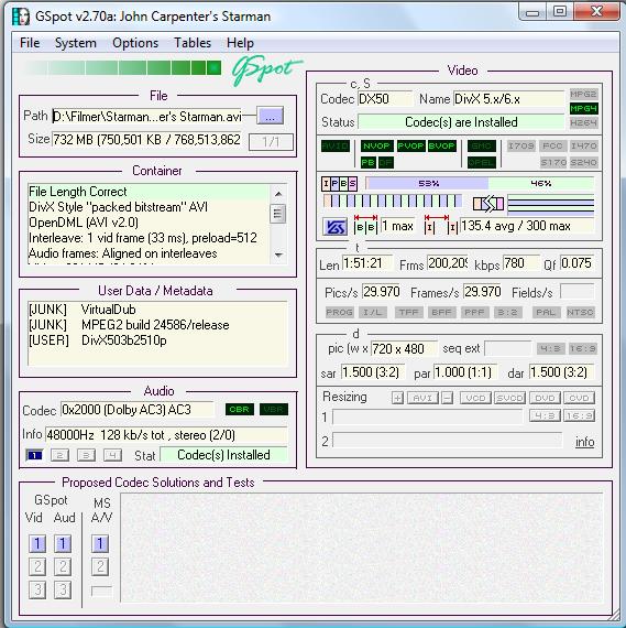

As for your source AVI, open it with GSpot, post a screen cap of the GSpot window. -
The .m2v file looks normal and yes it plays all the way through and no it doesn't seem junkey at the end :POriginally Posted by jagabo
here comes the GSpot cap:

Your video is encoded as progressive but it contains top-field-first interlaced frames. The frame size is correct and the frame rate right for a 4:3 NTSC DVD. Just use AviSource(), forget the resizing and AssumeFPS(). Open your AVS in HCEnc and tell it to encode 4:3, interlaced, top field first.
Extract the audio as an AC3 file then use the m2v and ac3 in your DVD authoring software. Again, be sure to set the video to interlaced, top field first, 4:3.
