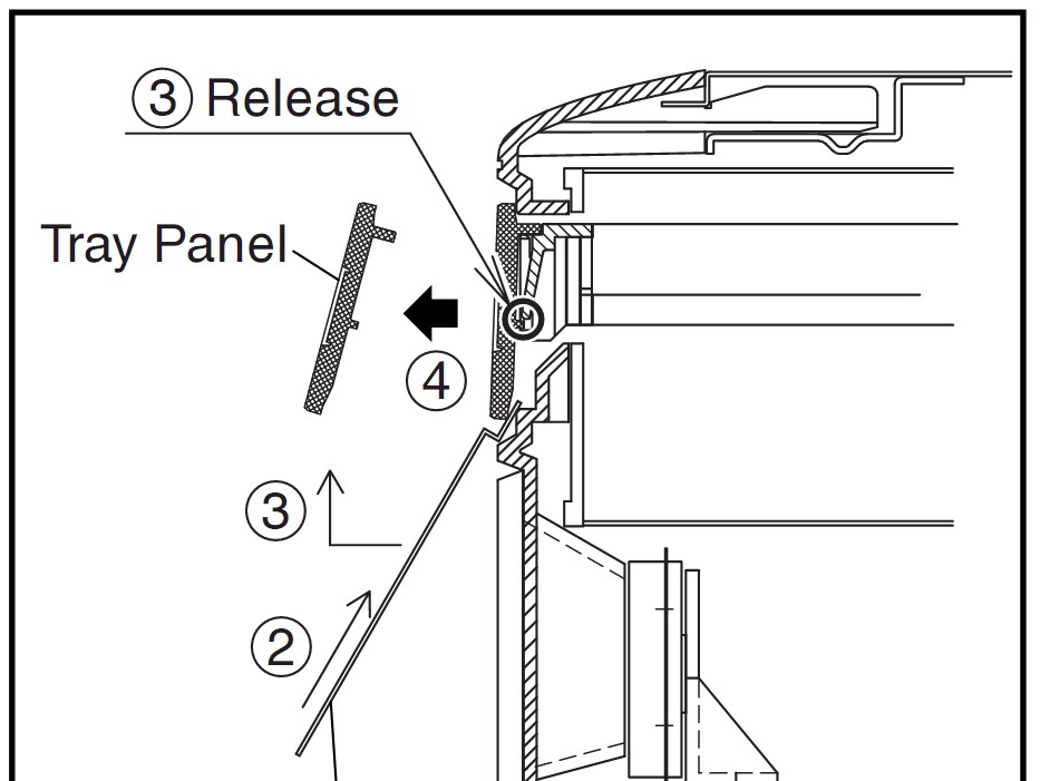

    Hope this helps

    that's the unit, thanks. i printed out the picture and tried to follow the directions. i didn't have a tool quite like that but i had a staple remover which has a similar rounded end on it so i tried that. i got it pried in underneath the front plate but when i tried to pull up on it, it just bows out. i am not sure how much pressure i am supposed to put on it to catch the release.

    i tried that too. as i said, i am not sure what is supposed to happen once i start prying on the front. i could very easily put more pressure on it, but i don't know if it would break off, or if there is a release button of some sort underneath that i am supposed to be hitting.
    also, i don't understand what the tape is for.

    The tape is prob. so you don't scratch the case edges.
    Redding, California
    Slide the tool under the tray panel then pry up and out. You may have to do it to both sides.
    I agree with wabjxo about the tape preventing scratches.

    From that sketch, it looks like a "press fit" and you're just trying to pry the bottom edge out enough that it becomes "unpressed" due to bending the bottom edge out? It prob. runs the whole length of the door so that's why they show prying from the center?
    However, w/o a top view, you can't be sure... it might just be "tangs" that fit in the groove at certain points rather than a solid piece running the length of the door?
    Redding, California
    I agree it's a press fit. Once you get something behind the plate, pry it straight out.
    The other pic shows 2 release points so I would try 1 at a time.

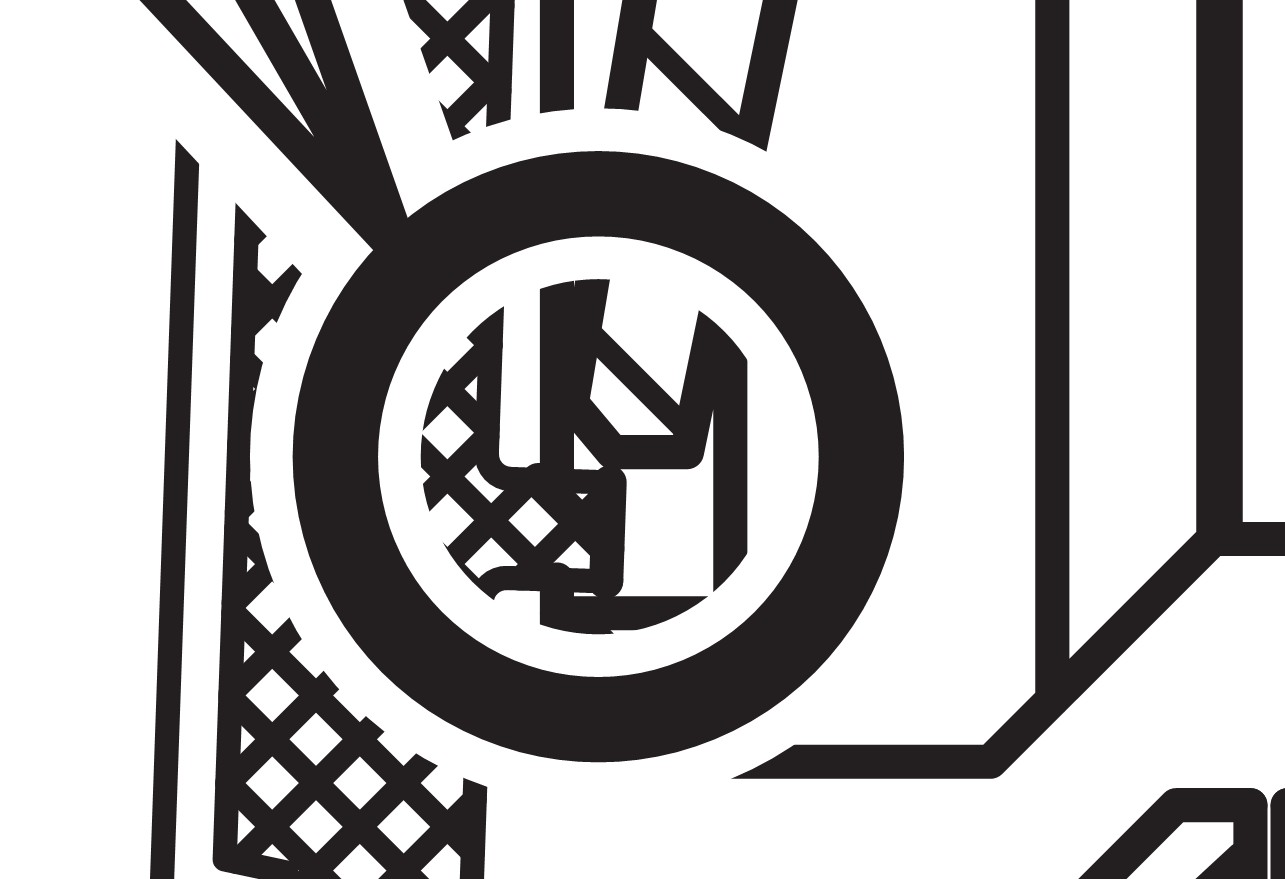

    Kevin, If you're worried about braking the tray panel, I'll give you the part number and where to order. Cost is $8.63... so go for it.
    Here is a closer view of the release points.
