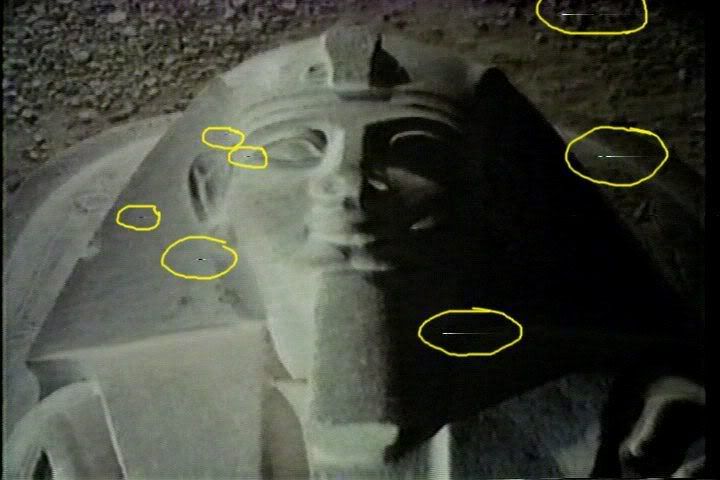

I'm looking for a way to remove horizontal white scratches from a capture made from an old VHS tape. They're apparently the result of either damaged tape heads, or maybe just the fact that the tape was old and had been played hundreds of times. Here's an example of what I'm talking about -
The scratches are not static - they skip around a lot (but only horizontally) and vary in length from frame to frame. I've tried many VirtualDub filters (e.g. temporal cleaner, dynamic noise reduction, 2D cleaner, etc.), but with no success.
Any advice would be much appreciated. The VHS capture that I'm trying to restore is of a rare documentary, and I'm really hoping that there's some way to remove those scratches.

	It's called dropout, and it happens when oxide particles flake away from the videotape. To best minimize, you'll need to play the video out through a Time Base Corrector (TBC) that has a dropout compensator (replacing white lines with video information from the line above or below it). If the expense of such a device is not feasible for you, you might try some other filters for VirtualDub or Avisynth, but I have not seen any that are very effective. The slow, laborious way would be to go frame by frame and Photoshop out the dropout flaws.
 Take your pick: 1. fast and expensive, 2. slow and marginally effective, or 3. perfect but extraordinarily labor-intensive.
	Have you tried a different VCR? I have tapes that show this type of dropout on some VCRs but not on others. Life is better when you focus on the signals instead of the noise.

	Thank you for your replies. Unfortunately, I don't have the tape from which the capture was made, so I can't do a re-capture.
 I'm afraid that manually repairing the dropouts frame by frame might be the only solution, but that would involve working on several hundred thousand frames and would be impractical.
