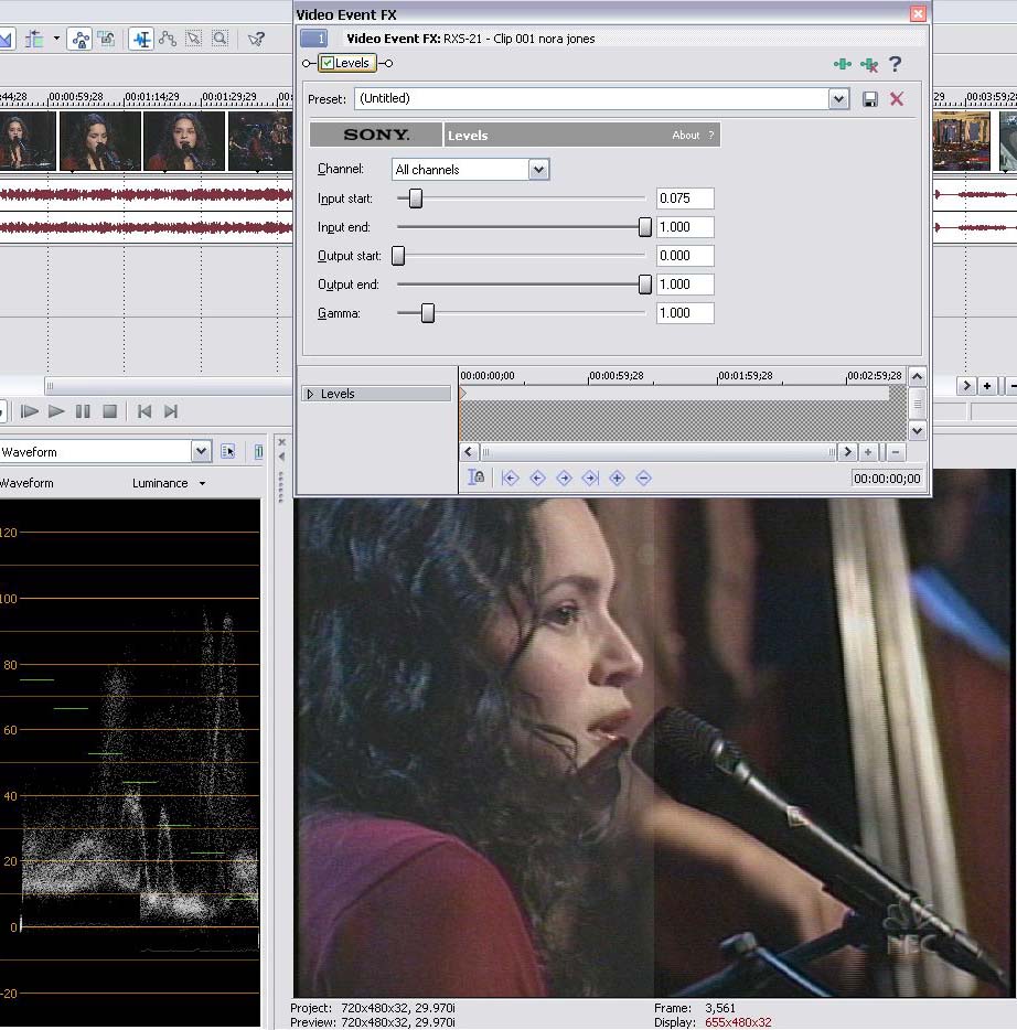

Pass-through capture to a DV camcorder unfortunately doesn't adjust for NTSC setup. This results in 7.5 IRE black capturing to digital level 32 instead of 16. You need to correct the black level with the Vegas "Levels" filter or the NTSC capture will appear washed out.Originally Posted by tripecac

I agree monitoring method is his first issue, but analog NTSC "pass-through" captures to DV still need black correction from 32 to 16 or they will appear washed out. This wouldn't be an issue for PAL capture.Originally Posted by 2BdecidedRecommends: Kiva.org - Loans that change lives.

So I think black correction is a good idea. In theory, it would make my DVDs look *better* than the DV in the camcorder, right? -

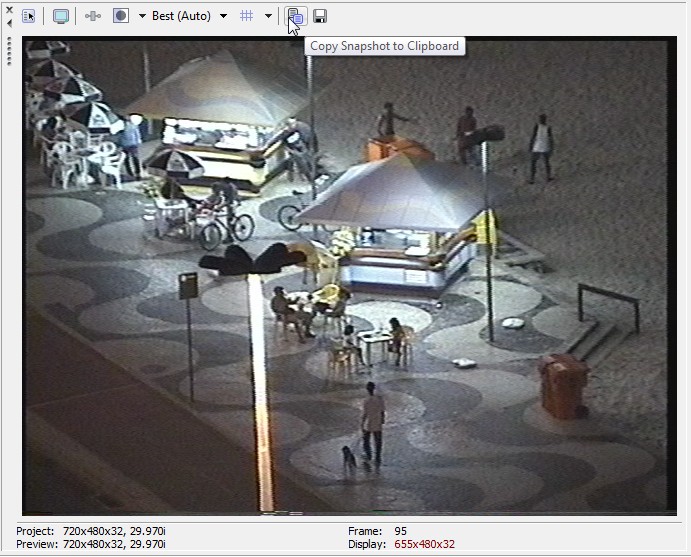

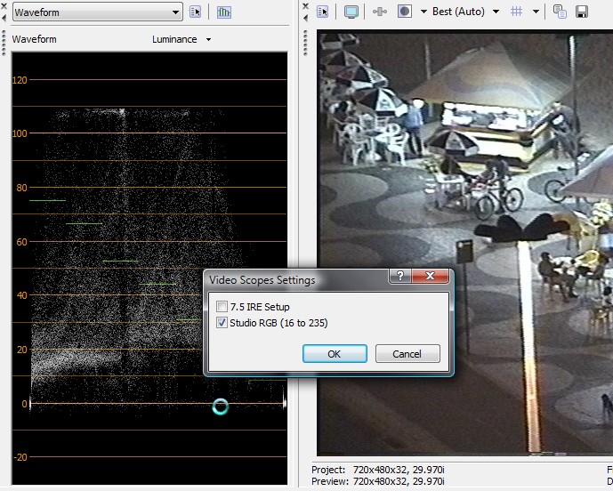

The difference will look something like this. Source here was a very noisy analog cable system capped S-video through a Digital8 camcorder. This should be "rendered" at the same time you encode to MPeg2 for DVD. The picture should look much better than this computer screen cap when viewed on your TV.
Left half picture is as captured (black at 32). Right shows black lowered to ~16. Look at the microphone.
BTW: Get your scopes working and show us some screen cap samples similar to this Video8 cap.

You need full Vegas for the scopes I think.Originally Posted by tripecac
Post some caps here. Does Movie Studio have the "Copy Snapshot to Clipboard" button?
If so cap some examples, paste to a photo editor and save as jpg.

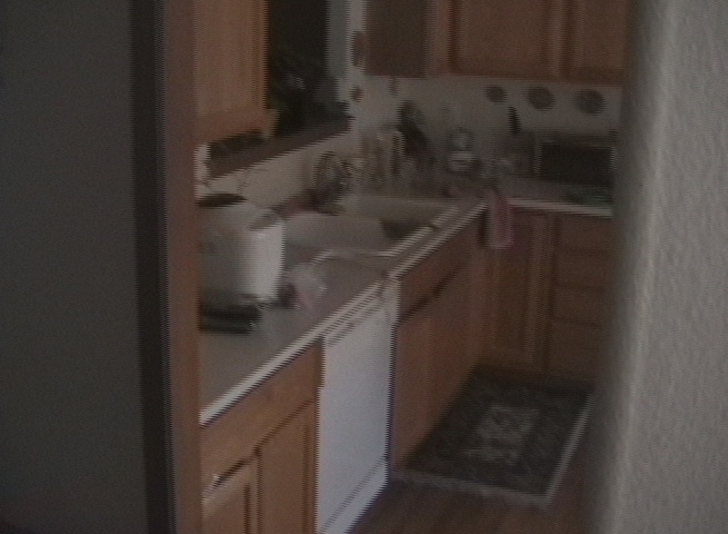

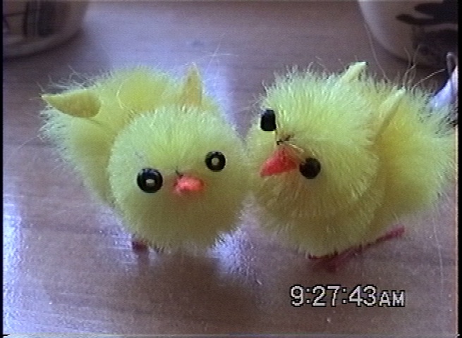

Ok, here are some screen grabs:
( http://tripalot.com/issues/images/20080703-capture-grabs.jpg ) -
Individual frames full size (720x480) would be more helpful.
http://www.kiva.org/about -

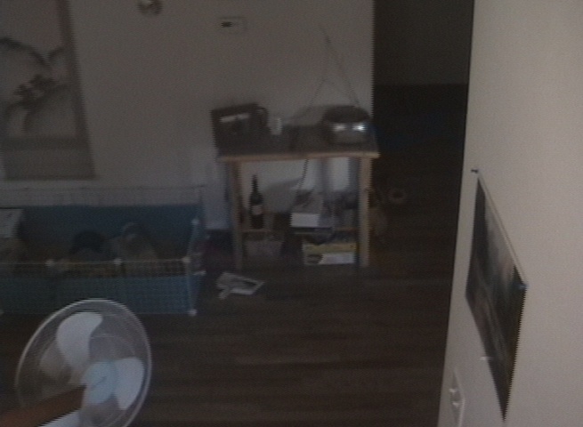

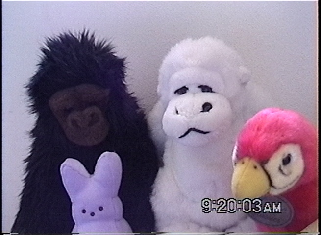

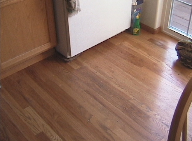

Recorded w/ DV camcorder:
Recorded w/ analog camcorder, and then captured to DV camcorder:

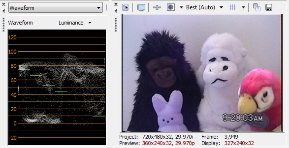

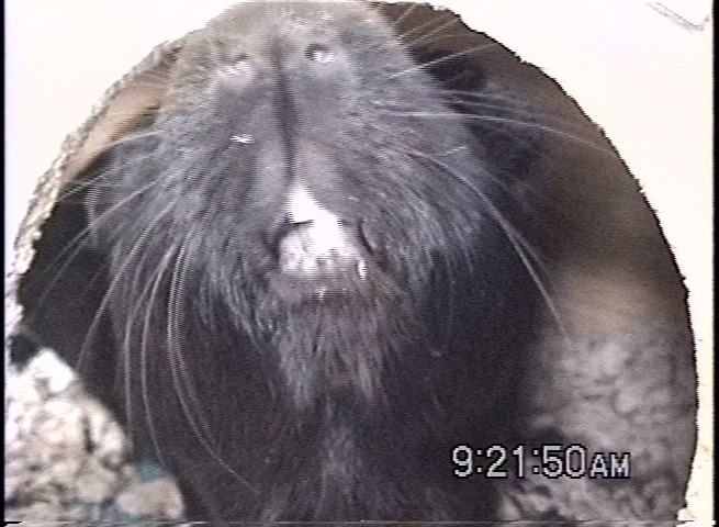

I'm impressed with the Canon ZR40. Unlike the NTSC Sony, JVC and Panasonic consumer camcorders that I've used, the ZR40 does pass-through capture with correct black level (digital16).

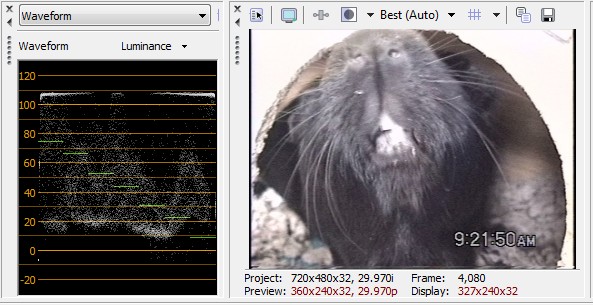

Your an1.jpg shows technically correct black and white (contrast). The reference indicator for the analog source is the black stripe down the left and right side. Broadcast TV picture width is ~704x480 so capture at 720x480 pics up ~8 pixels of blanking left and right. For NTSC, blanking should be 7.5% lower than black. That dot you see below zero% on the waveform monitor indicates the correct blanking level for analog NTSC.

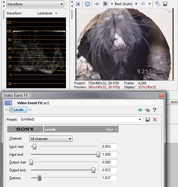

Your Hi8 camcorder wasn't as successful setting black and contrast (iris+gain) for the an2.jpg frame. Most camcorders set exposure with center weighting. This subject had lots of black in the center so the camera opened the iris too far causing light blacks and over white sky.
You can improve this exposure with the levels and other filters. Here I used the levels filter to lower black to 0% (digital 16) and bring white down to 100% (digital 235). You would adjust further to your preference while watching the TV monitor.
